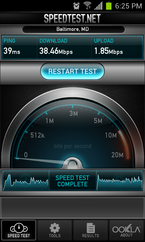

Yeah, just checked mine and I am getting nearly as much on the phone as I am with the computer. I get 45 Mbps with my laptop.

"Baldilocks" , what is your internet connection speed ?
Anyway, your results looks the same percentage drop in speed : ~ 16% .
I have a 40Mbps Down/3Mbps Up Connection.
My computer averages anywhere from 38-46 down. The phone usually stays right around 38-39.
When dealing with very high speeds it doesnt matter so much as in low speeds
( like "gbswales" who posted the first post)
