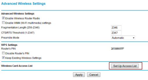

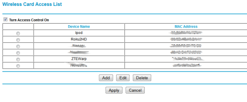

This happened to me when I got my iPod touch. Took me two weeks to figure it out. I have a netgear router and it has a "Wireless Card Access List" setting which only allows specific (or allowed) devices to access your network.
Regardless if you know the pass-phrase, It still won't allow access to the device. Was pulling my hair out too when I got my galaxy prevail cause I had forgot to allow access and wasted 3hrs of my life trying to get it to connect. It would connect for a split second and then drop.
All I had to do was enter a label for my device and the phone's mac address and I was good to go.
Possibly your router has a setting like this?

I looked at the settings in the images and my router looks nothing like that....it is really indepth and has a lot of settings I do not get into so I will look closer and see if anything looks like that though....Thanks for the reply....will let ya know!!! :)
BTW....where would I find my mac address?
