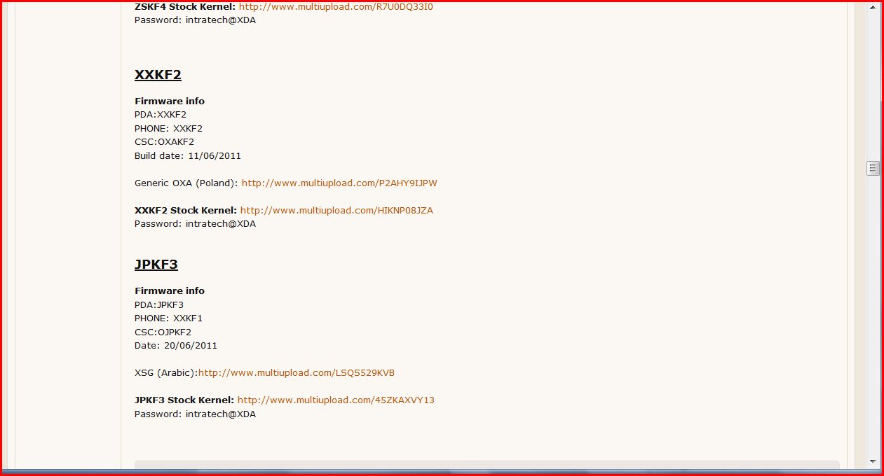

Ok, I'll give that one a go.
I'll install the larger file then the kernal.
My harddrive is bursting with all these ROMs and kernals. Trying more or less anything to see if I can get them to work!!!
Should get back to you in about 20 mins when they've downloaded.
