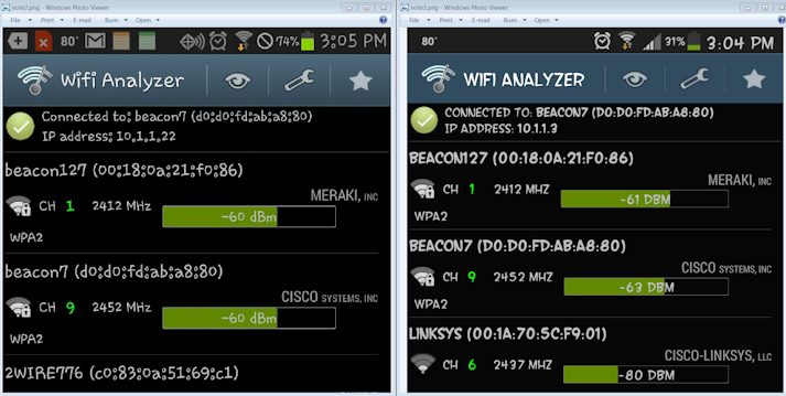

I have seen a few people state they have poor wifi compared to their last phone. Others chime in stating they are not going to purchase a note 3 if there is a Wifi antenna issue.
I pulled out my old Note 2 and ran identical software measuring dbm on each device for over 30 minutes. The Wifi reception on each device is almost identical. I am not seeing this issue that others have reported.
If you are having Wifi issues, please take your phone back to the carrier and let them run a diagnostic.
See the attached side by side comparison.
Also, if you respond to this thread, can you post your carrier. Just curious. Mine is Verizon.
