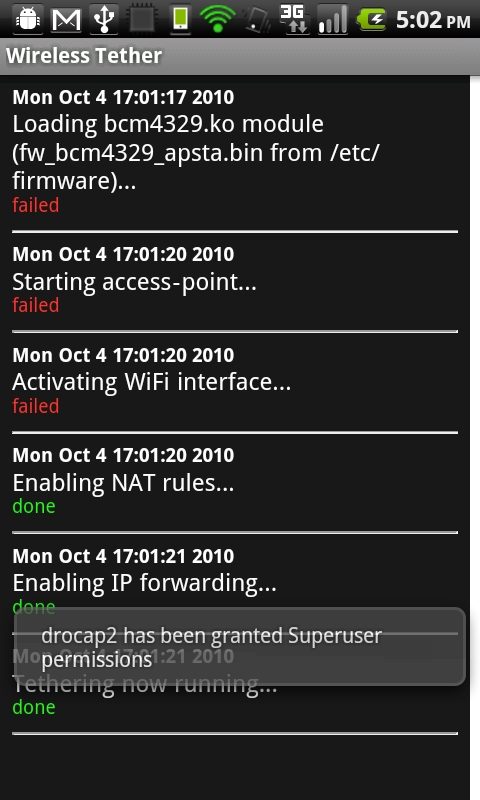

Did everything mentioned in the thread, but it said "Tehtering started with errors, check log..."
And the errors are
