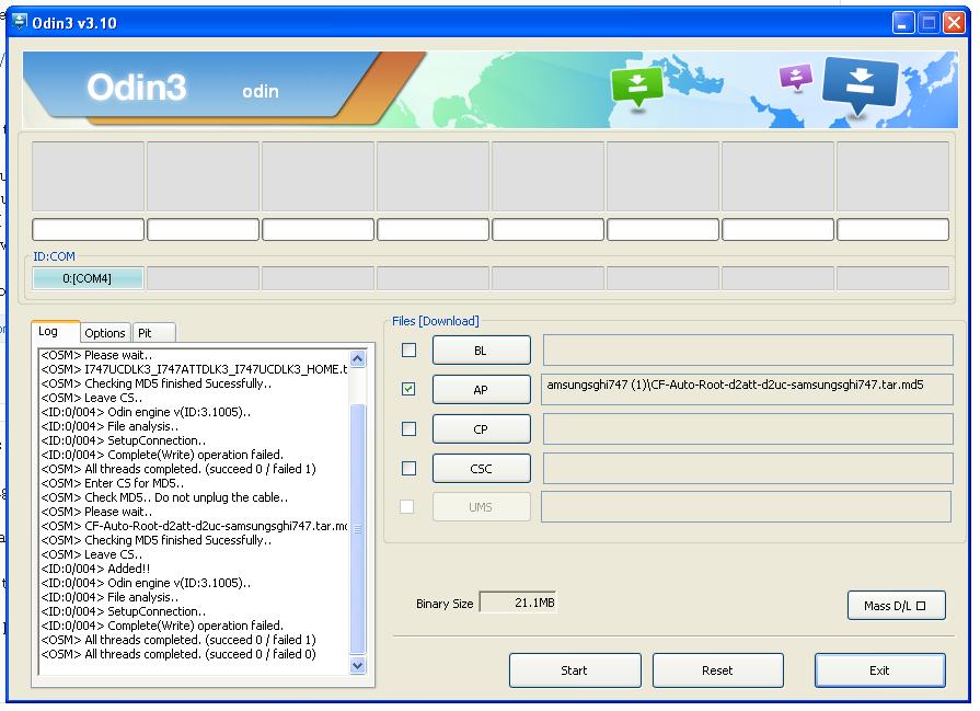

Dear all,
I think I have bricked my Galaxy S3 SGH-I747
I have tried Flashing TWRP recovery which was was successful, after that I tried flashing the stock rom downladed from Sammobile which failed.
I then tried to flash the Rooting file from Chainfire which also failed.
I am attaching the screenshots and would much appreciate any help.
Thanks in advance

The stock firmware that Sammobile has is the first version. If you had 4.3 or above on the phone you can't downgrade back because of Knox. Do you remember which version you had on the phone?

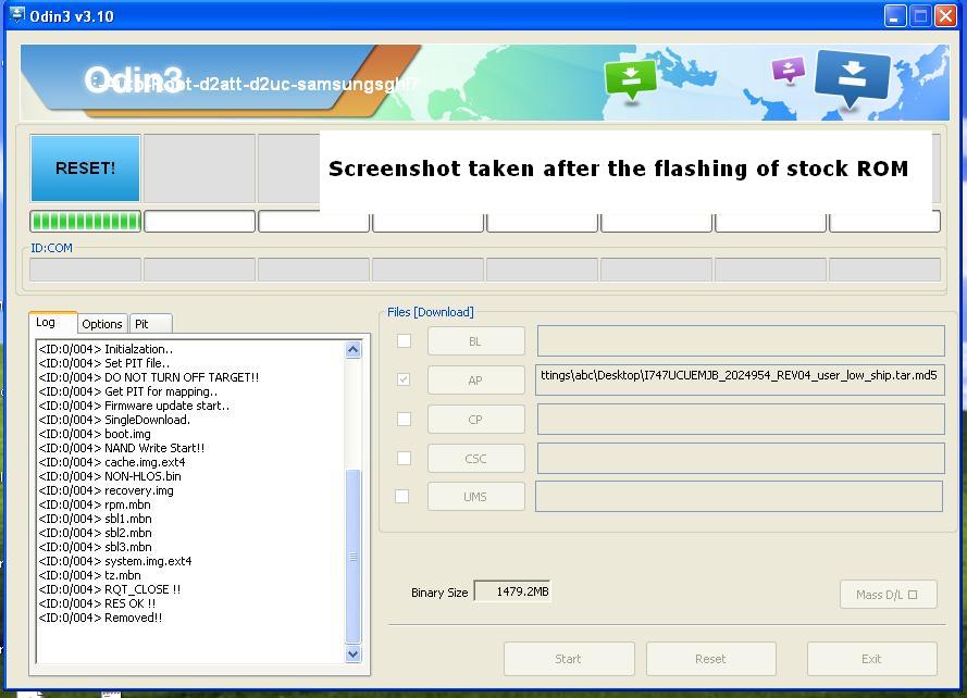

I am attaching some screenshots which may give you the exact idea of what is going on with the installations.
Yesterday I tried to flash custom recovery just to check if that was successful and to my surprise the recovery file flashed correctly. Name of the file is " philz_touch_6.07.9-d2att.tar.md5"
Today I tried the stock Rom as advised by you and that too flashed correctly however the phone did not boot after Odin sent the reset command. A small message reads "Verifying Booting...." in the left hand corner of the screen when it was trying to boot but fails to boot.

After you flashed the stock rom did Odin give you a green Pass, Success 1/ fail 0? If the stock rom was the last thing you tried, boot into the stock recovery and select Factory Reset and let me know what happens.
I think the green Pass comes when the mobile boots after a reset command is sent from Odin.
I however did not receive any negative message till Odis was flashing the stock ROM.
Stock ROM was the last thing that I flashed but the problem is that I could not boot into recovery nor could I boot the mobile.
Every time I try to turn on the phone it displays a blue message "verifying booting"
Is there a booting area which could be corrupted and stopping the mobile from booting?

Odin should have given you a success or fail either way. You can try to flash the firmware again.
