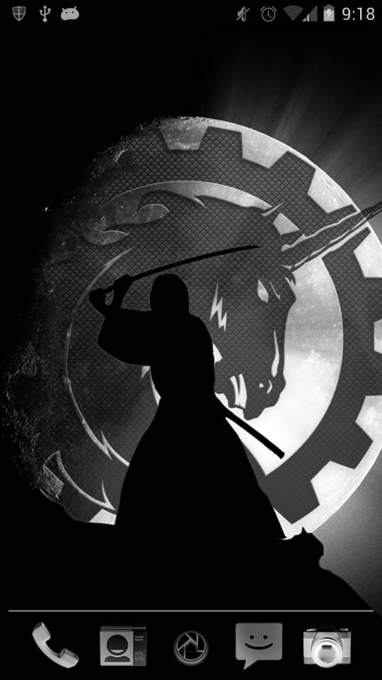

Aokp, my new daily now that MMS works ;)

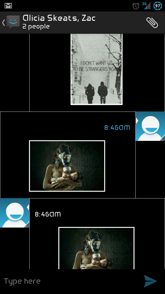

also, this is happening:
i receive a pic msg and mms.apk shows the sender and myself in the top left like its a group msg. when i send a msg back i also receive a duplicate copy of that msg.
i'll post a screenshot
