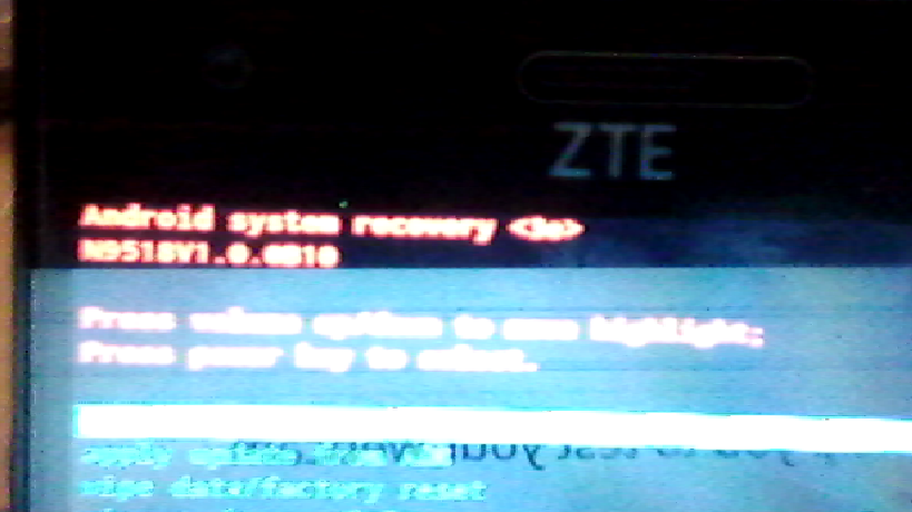

Hey, I think that I might have found that recovery mode (yes I'm using a ZTE Warp Elite N9518)that you're looking for...
I'm not sure if it'll be of much help if you've already found it but how to get to is is by:
1. Hold power button and volume down keys until phone shuts off (it will take a screenshot first but ignore that)
2. Keep holding until ZTE logo appears, at that point release the power button but keep holding volume down button until the menu that can be somewhat seen in my super shitty picture appears
