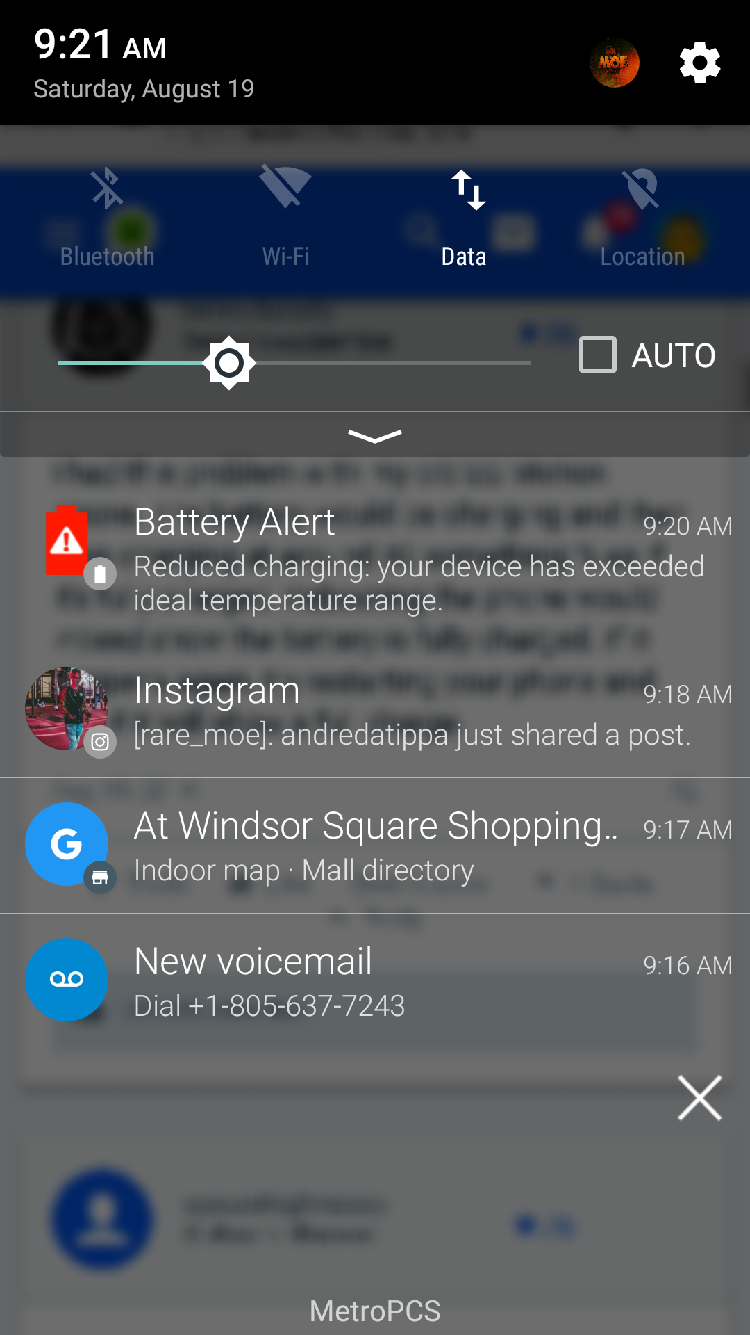

And now i get this evertime i plug it in
