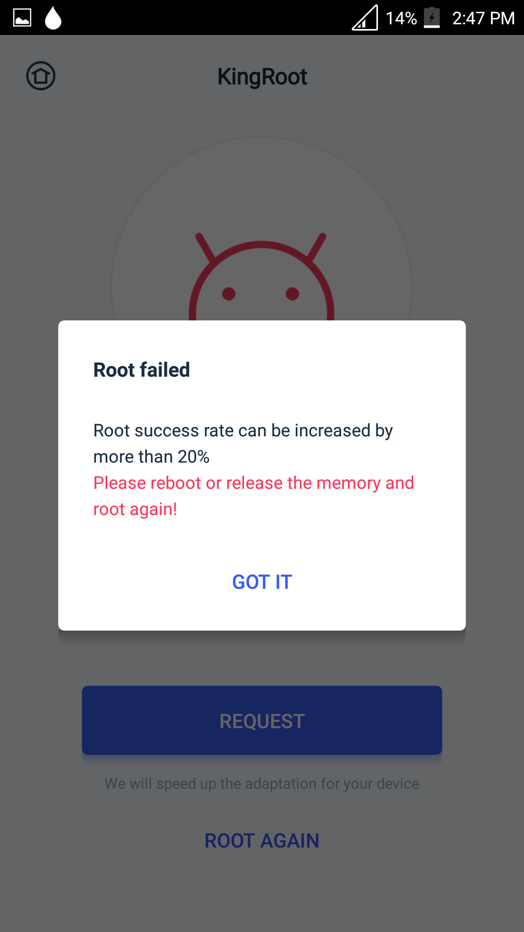

Seems King pushed a new package. Give it a go people.
