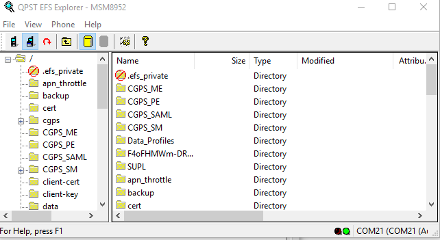

//QPST EFS Explorer (Currently communi...holy shit. We have read access
//Error NV read only state
//So no writing for us eh?
//Backing up NVMemory from phone: Success (A little tip here. Use QCN and NOT XQCN.
//Restoring the just dumped NVMemory: Success! (We have write access)

*Edit Holy **** we can communicate.

One of the screenshots posted was of the cert partition for all debug/user key and encryption storage

//Reinstall driver as Qualcomm HS-USB QDLoader 9008 (On port 21) successful.
//QPST detects phone as 'MSM8952'
//QPST properties of MSM8952: No MIN Analog, STATE Entering CDMA, VERSION MPSS.TA.1.0.c3-00069-8952_GEN_PACK-1.55637.1.58990.1, MSM 2300-A2
//COMPILED Jun 22 2016
//Service Port Mapping: ERROR Could not read RDM_DEV_MAP from selected phone
//SWITCH MODEM TO DIAG (Did nothing?)
//START CLIENTS- BACKUP instantly crashed QPST
