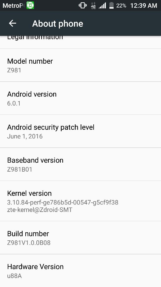

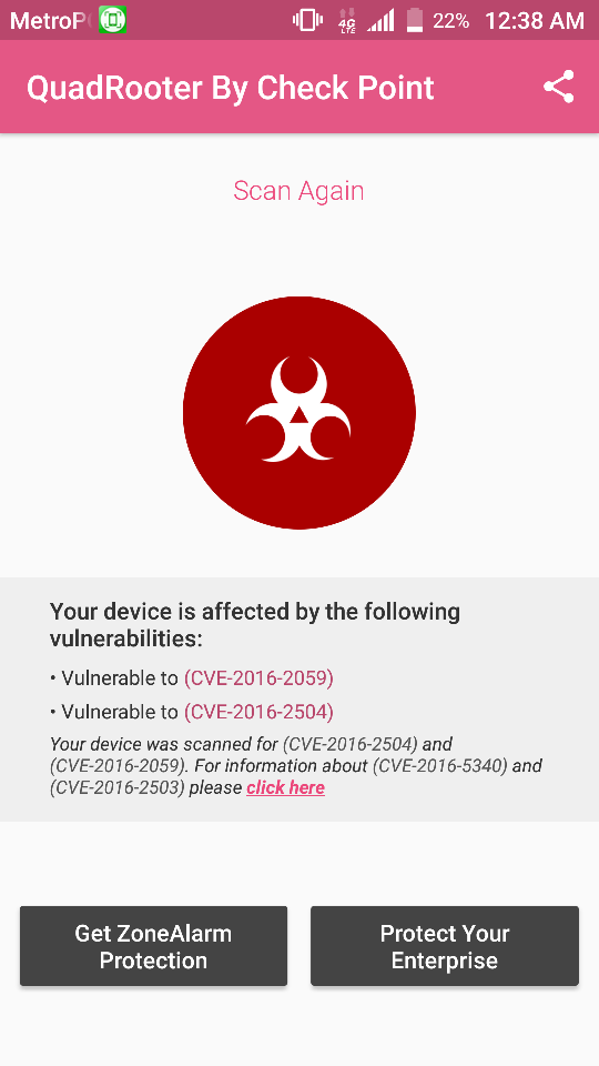

<a href='http://androidforums.com/attachments/117684/'>View attachment 117684</a><a href='http://androidforums.com/attachments/117685/'>View attachment 117685</a>loonycgb2Any of you mind installing quadrooter scanner off play store and see if it finds any exploits we can use?
Can you screenshot your results?How come it says I'm vulnerable to it and you're not? More people should check and then share the results if different.
What build are you on?How come it says I'm vulnerable to it and you're not? More people should check and then share the results if different.
Can you screenshot your results?EthorbitHow come it says I'm vulnerable to it and you're not? More people should check and then share the results if different.

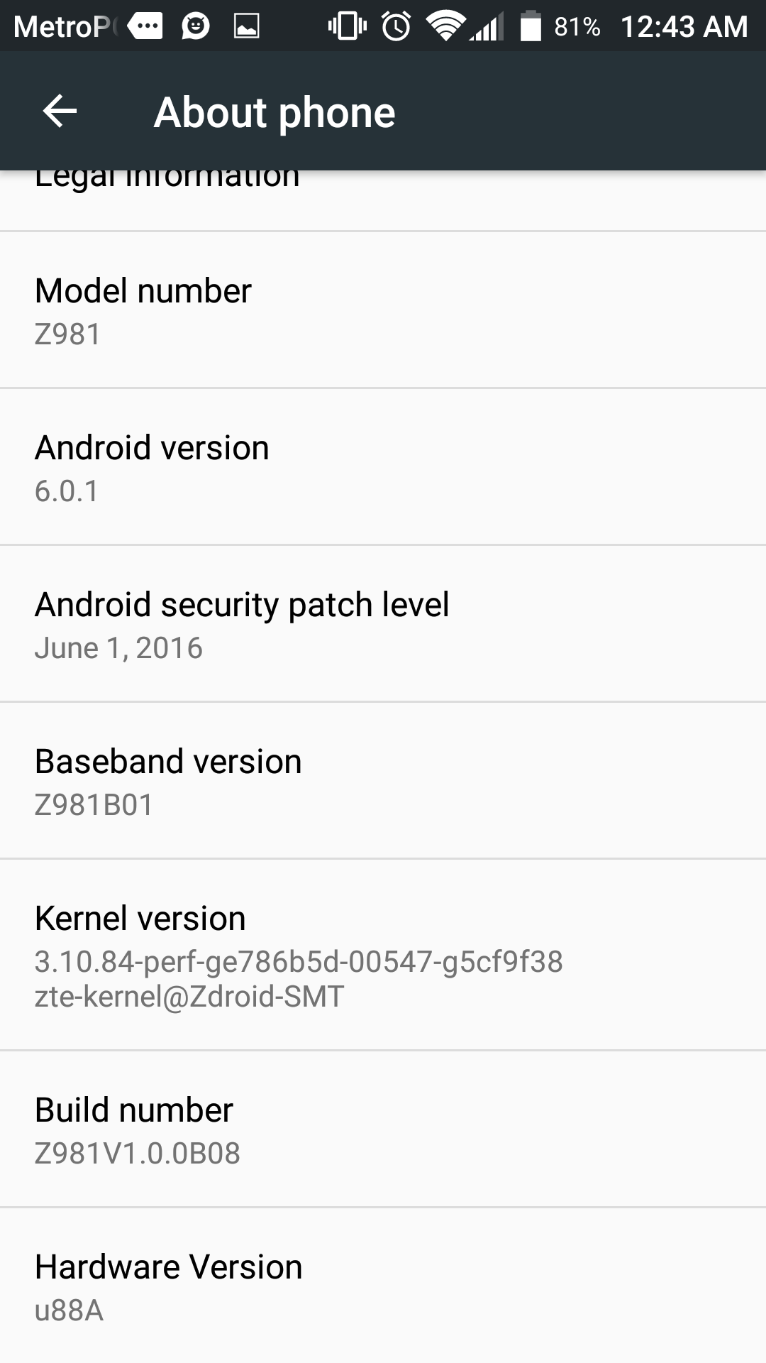

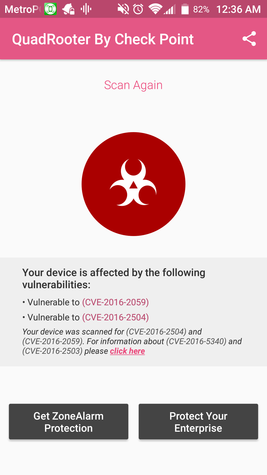

Dammit!!! Well... You're on b08, and I'm on b14. It seems the earlier builds are vulnerable to the cves. That means b08 can be exploited.
What build are you on?EthorbitHow come it says I'm vulnerable to it and you're not? More people should check and then share the results if different.
Now how do we go about thatDammit!!! Well... You're on b08, and I'm on b14. It seems the earlier builds are vulnerable to the cves. That means b08 can be exploited.
<a href='http://androidforums.com/attachments/117688/'>View attachment 117688</a><a href='http://androidforums.com/attachments/117689/'>View attachment 117689</a>iancc86What build are you on?
