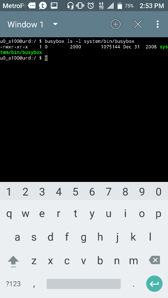

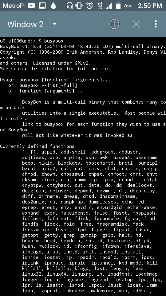

Busybox is preinstalled into /system/bin. No need to install a seconday busybox. It's already fully functional, just doesn't have userland permissions for the important things. Open terminal emulator, do "ls -l /system/bin/busybox".
Gotcha. Just didn't know if you could use it.
We can, just need the proper perms. It's read only, and I can't chmod into system. I pulled it into data/local/tmp to chmod, but the commands themselves are symlinked elsewhere
The post I linked you says you would have full busybox use. The permissions are correct.
That only applies to user installed busybox, not ZTEs busybox that comes preinstalled on stock firmware. We already have su from busybox, but it requires SUID, which I can't get as it requires different permissions. The userland permissions are there, but the root permissions are not.
I'm not interested in a psudo busybox that exists on userland, only the preinstalled one that resides in system/bin, that the permissions can't be changed without root.
