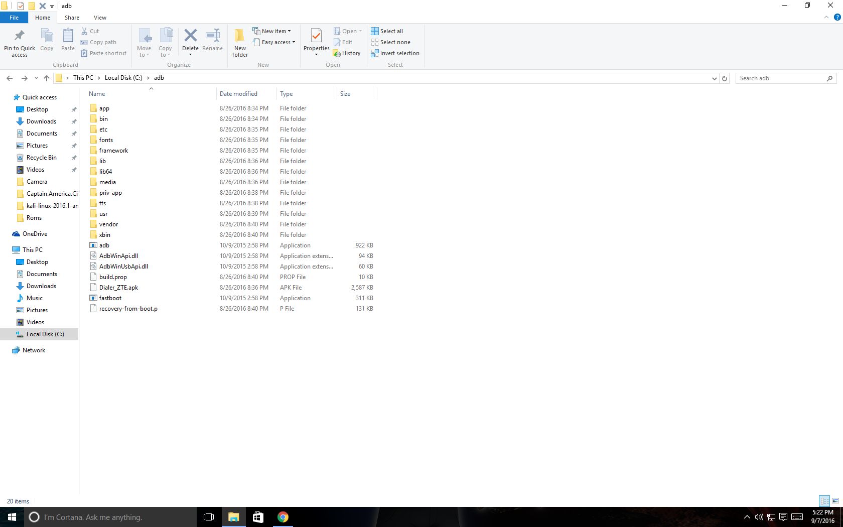

Idk if we are past this but I did adb pull system and this is what I got.
What's this? The contents of the device? Maybe paragon could do something with it.

Nah he cant, it denies permissions for some files. At least last time I did it. Its kind an incomplete backup. I can try again to do an adb pull though

Fastboot is in there cause it's his adb/fastboot dir and pull will put it in the same location. And sadly yeah without SU working and us getting the full thing nothing we can do. SuperSU.zip is a recovery flashable zip file that runs commands to put SuperSU.apk and the binaries into the correct system locations

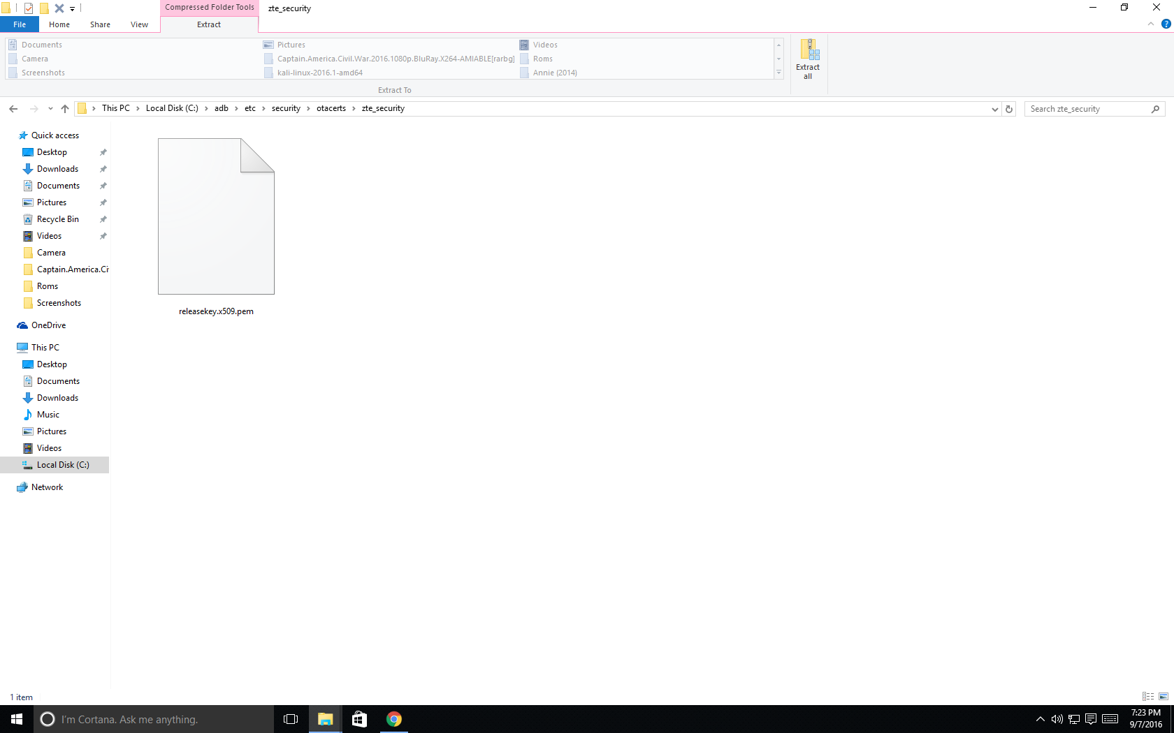

Is this useful??? if not my apologies just trying to help
found a folder named zte_security and inside was this...

Adb pull /system will only give you a partial dump of system files because there are a lot of libs and binaries that can't be copied without root privileges. As for pulling partition images from the device like a boot.img, recovery.img, or system.img that cannot be done without root access.
