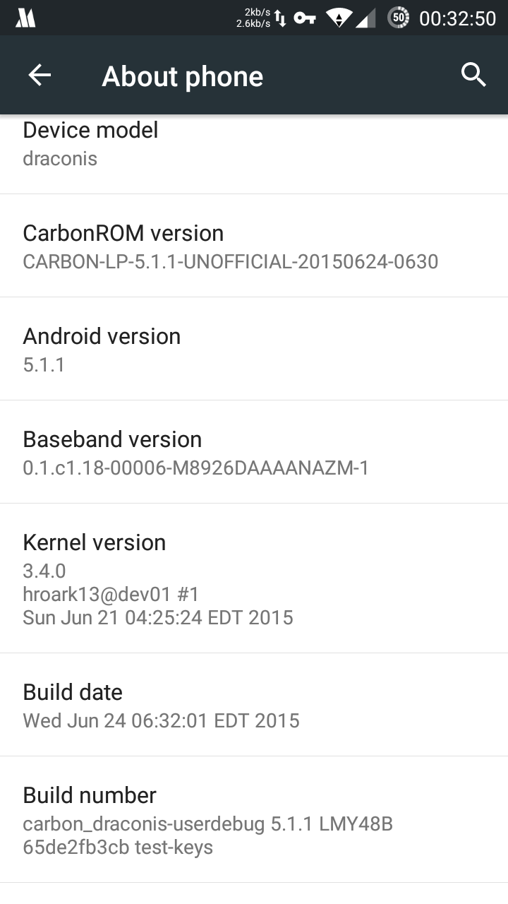

I have installed TWRP, BrokenOS, Carbon ROM, CM12.1 RC5, Blisspop and Candy 5. And they all run great.
I attached a screenshot of my phone information.
