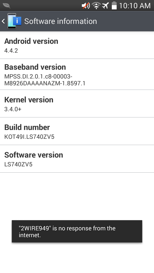

Idk what it changed but heres some screenshots the software and build num. If you need anything else just ask!
