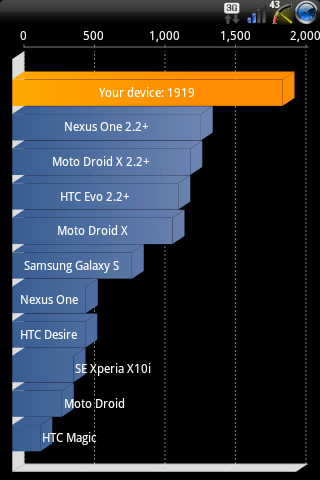

Root 2.6.35.14 kernel for cm7
This is the best of three . The other 2 were in the high 1800's . :D
CM7 Beta5 w/ DATA2EXT
SD Card - 16g class 10
No issues at all. Whole system booted up faster than normal. Everything seems snappier. No 3G issues from your regular kernel(2.6.35.14_CM7_B45_KRN). Did not have to turn on 3G at boot. Running CM7beta4-bhf3
Seems to be running well Hroark, I threw it on my phone with CM7 B5 and 3G and everything works fine. Phone seems overall snappier since.
