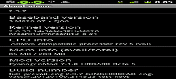

I am starting to get confused with the plethora of Roms and Kernels we are fortunate to be working with.
I suggest we post a screen shot of About Phone when asking a question. Or at least provide this info.

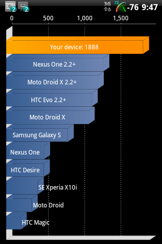

Hey Hroark
I wanted to try and helpful so I took the phone back to stock and loaded cm7 ver5 then I flashed both test ker and dtkern . Im running around 30 apps.
So,I did a couple of re boots and ran speed test!
The phone seems alot more responsive and apps don't disappear after reboot and 3g consistently!
Could only add one att
Also test scores up more then what I had.
Hope this helps!
Ric :D

will post quadrant standard when i find version everyone else is using... New one goes super slow for me and results are much less impressive <~1400 - ~1550> (even before i tried 'the solution')
that must be why my results are crap. ohh well. my phones running good. havent seen any problems so i would consider this stable. going back to testing prl's cause of my crap speeds.
its with the newest from the market, vers 2.0. idk why its so slow. i think it did the same with cm7v5 kernel but i didnt pay much attention
i mean i posted a link to the apk file, if you want, you can download it and install it and then do another test
