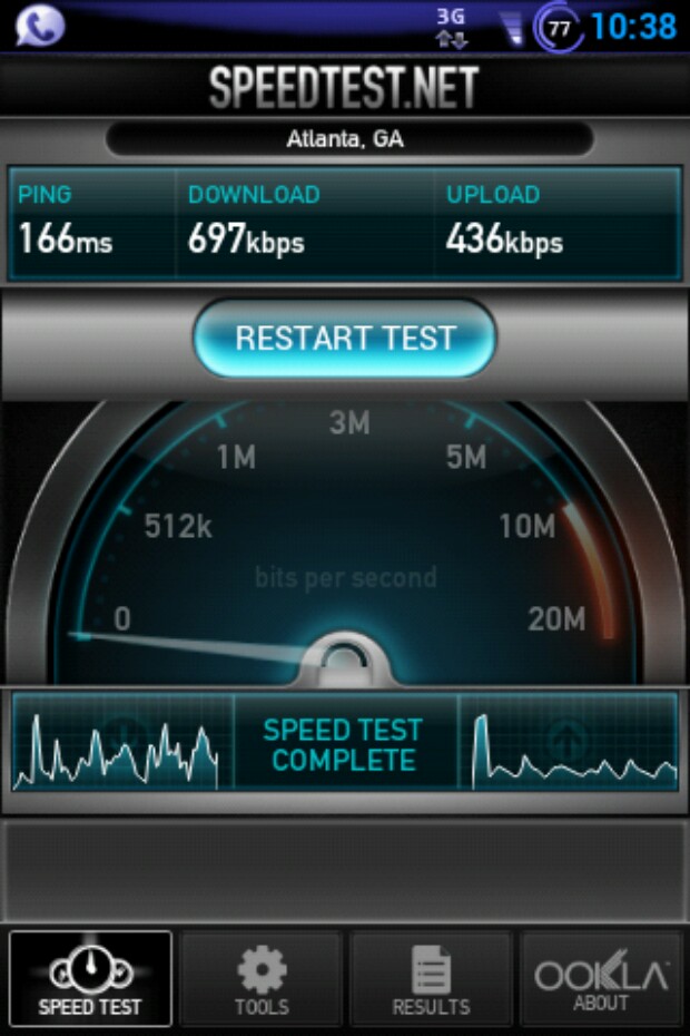

this is on 3g and being uploaded via my trusty OM.

1X is @like 240+ kb/sec
