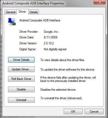

device driver still has google drivers for 'android phone', not the htc, see attachment. shouldn't running the htc...007.exe replace the goog drivers?
also the drivers, for in my case H:\, for portable devices is ms drivers

so, everybody remember me? stuck at 'waiting for device'
I have solved problem of getting su-2.3.6.3-efgh-signed.zip onto the card root, /sdcard, btw rxpert, sdcard, does not show on the win explorer for my htc, it was a 2 step process, first copy it to the DCIM folder and then copy it to /sdcard with astro.
I HAVE CHECKED AND DBLE CHECKED, have done all the steps from the guide including options and other things in another post for waiting for device, and still stuck. is there some way to check if the drivers from HTCDriver3.0.0.007.exe are installed? what are their names? are they supposed to be in C:\Windows\System32\drivers\?
see my earlier post with pics of my disk drive drivers and win xplorer
fast boot is off, debugging on, charge only, no htc sync or other, all virus, firewall etc is off,
ok finally, success, I'm s-off, installed the super user and did a backup. I connected usb to disk drive so I had the driver info (goog) available in devices, from there, I unistalled the goog drivers, and ran the htc .exe driver install, then took out battery and rebooted, and then the htc drivers were in finally there, evidently revolutionary needs that for sure.
so guess you have to do that process if some other drivers like the goog are already installed to allow the htc set to take effect.
