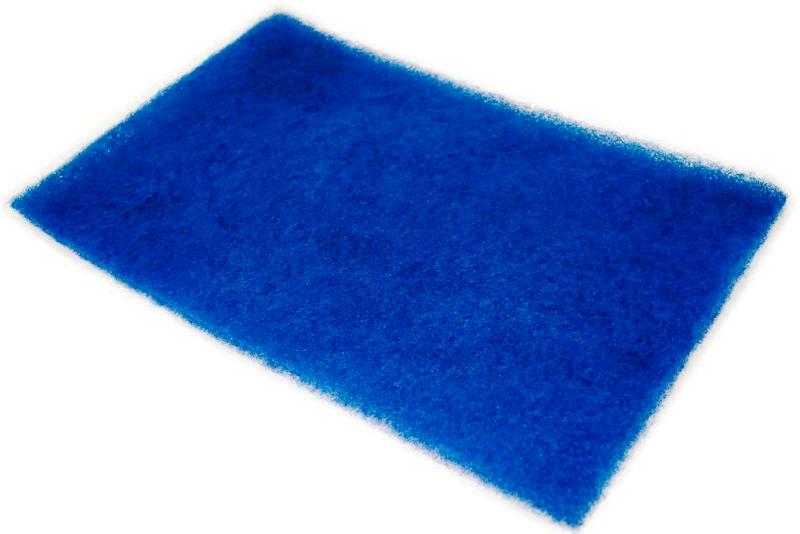

Please do not use pleated filters, they do work better, but equate it to the dirty filter situation. They reduce the air flow when new and after they accumulate some dust/dander, they really cut the air flow down.
Just a thought, did the tech open the machine and look inside ?
Some brands come with a factory installed fiber filter and if it is allowed to remain in the machine and never changed that will drastically cut air flow.
If there is provision for a external filter, I always remove this filter, and do not replace it.
It will be inside the machine and look like this :

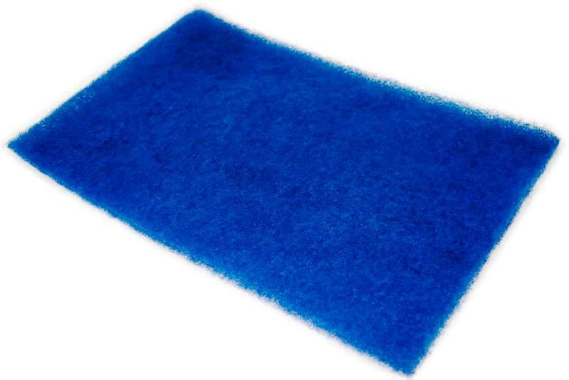

i just got a pleated filter from Home Depot. did not see any that looks like a filter pad rather than a pleat. where can i get non pleated filters? amazon?
