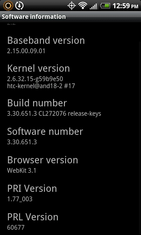

I think the easiest way to figure out your problem is if you tell us step by step what you have done, in detail.
I consider myself relatively tech savvy and the last update I was doing I was trying to flash a ROM for the DInc onto my EVO. Needless to say it wasn't working and was nothing but frustration. The kind help of everyone on the forums sorted it out for me though!

Well there we go, your radios among other things need updated. You can flash them separately but I would go to the link in my sig and flash sprint lovers. It will update everything at once. Make a backup first including wimax. If you are on clockwork 3.0.0.5 it will do this automatically. Then wipe everything and flash sprint lovers. Make a back up and then flash on to cm7 rc4.
I'm not sure what script sprint lovers is in so you may get an install error. NO worries we will just have to change your recovery.
