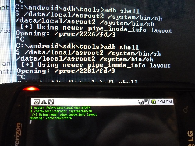

Anyway, I'm stuck at "asroot2". Most people seem to have failures where asroot2 simply doesn't give them a root shell, but gives them a shell none the less (and claims "success"). Mine does nothing, it just hangs when I run asroot2, and while it hangs, it makes a copy of itself and both processes use full CPU time (each one using 30..45% CPU). If I run it with no parameters it gives me "/data/local/asroot2 args", kind of a basic way of saying "tell me what to do, dummy". Still no luck.
I've had the ADB and terminal tools on my unrooted Ally for quite some time, so I had more of the root process already done than I thought. Now as I get more and more sick of the background apps launching (city ID, amazon mp3, and a random assortment of apps I've installed over the months) and running in the background, I figure it's time to gut this thing and clean out all the crap.
I've applied each update that's come OTA, in hopes that they'll fix the buggy software bundled with it. My version shows "SW version VS740ZVB", "Firmware version 2.1-update1", "Build number ERE27". I'd like to try to avoid "restoring" (resetting) it if at all possible... I've got a good number of apps and customizations I really won't much like to have to reset :/ Just wanted to be able to take screenshots and remove the crap from the phone ;)
Any ideas?
Any ideas?
If your on VS740ZVB this method will no longer work as it has been patched from my understanding.
Use Unviersal Androot from this site to get rooted. Android Ally
Awhhhhh's, crap. That's what I was afraid of. Well, good to know, I googled the heck out of it and haven't had any luck finding any info about any patches having broken rooting.
No problem with downgrading anyway, since none of the OTA patches have fixed any significant issues - only fixed the home wallpaper alignment when switching orientation modes. I've got a falcon on mine and when I'm on the center screen, he's perfectly centered on the screen, but if I switch to landscape and back the picture would be off to one side until I slide screens, kinda annoying. Now that's fixed, but everything else is still broken, hence it's time to take matters into my own hands ;)
edit: HAH! Awesome! Didn't even need to downgrade or anything! "Woot! Your device is rooted!" - happiness! Thanks for the pointer :D
