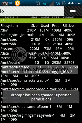

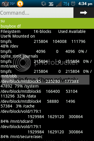

The cache partition is 57mb on this device, and the dalvik itself is near 100mb. If I could alter the partitions themselves this would be irrelevant since "dev" is wasted space, having only 32kb taken out of 211mb...
Partitions that I know:
system - 210mb (47 available, mainly apps)
data - 162mb (17 available)
cache - 57mb (56 available)
dev - 211mb (36kb used)

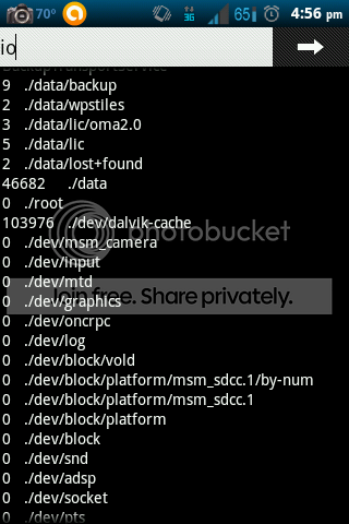

Picture proof that this works (I'd take a pic from a file viewer, but they don't want to cooperate:
