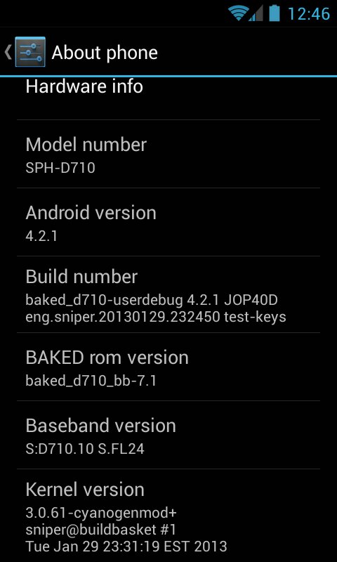

This is the one I'm on. I'm not having that issue. Just tested when I make the call and when I receive the call

Lol I just seen that. Yea I'm on 1/29 build..
You don't have to do it all again. Just download the 1/29 version of the rom. Boot into recovery. Flash the ROM clear caches and you can see if it will boot without wiping data. If it doesn't just boot back into recovery wipe data. If you wipe data you'll have to wipe dalvik cache and flash gapps again then boot the phone.
