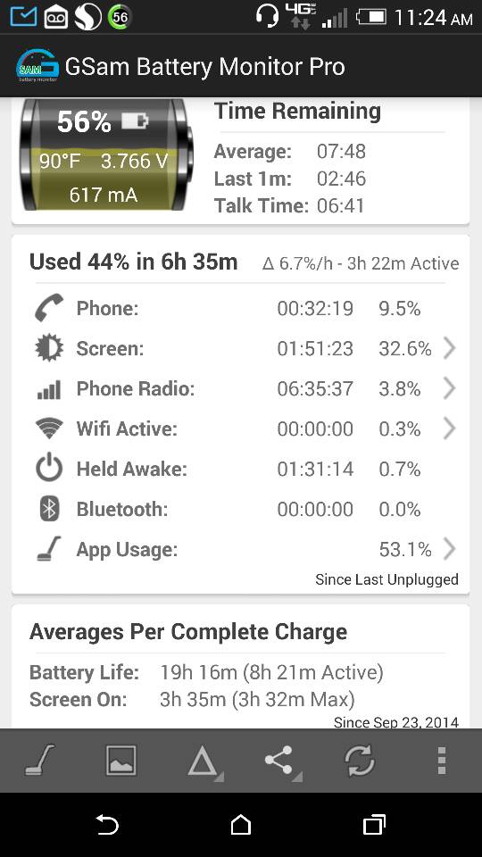

Take a look at this, after going through the process of removing cache, here's my current battery life the next day.

Looks OK to me. You're probably gonna get 4 hours SOT on time on 4G with a half hour phone call in there.
Most people who get over 6 hours are on wifi the whole time.
