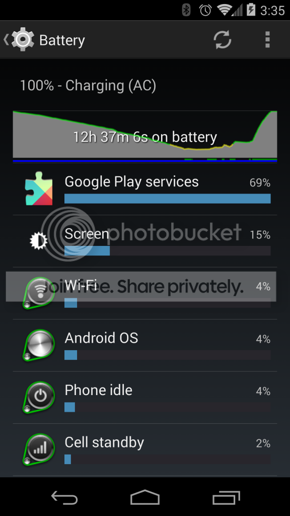

Unlike others the Google Play Services on my N5 is using up the bulk of my battery!
Is there any way to disable it or turn it down?

Thanks jhawkkw.
You're right.
I just rebooted and it disappeared!
Man I thought Android is far better than Windows which needs rebooting to speed up the OS!LOL!
Next time I notice this I'll reboot!
Cheers

Normally just force stopping it would be enough, but we don't get the option to do so in the app manager. :(
Thanks
I got hit by that today as well. Generally rebooting the device kills the service.
I was also hit by this Google Play Services battery drain - turning off Location services has completely eradicated the problem. The location settings even showed high battery usage from Google Play services. Yesterday it was using 60%+ of my battery.
Today, Google Play services doesn't even appear in my battery usage :) and I have a noticeable improvement in battery.

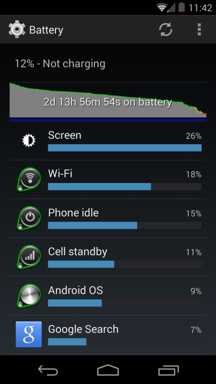

Last Night I rooted and installed the nitrous rom. This morning I unplugged at 6am. I've done some email, some amazon, bbm, browsing and lots of tethering. And this is where I'm at. I think it's pretty good.
Well I was unable to upload the file, but it said 51%
I finally got the picture working
