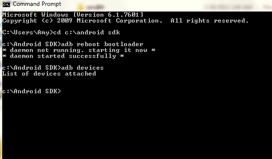

stuck at #6
At #5, after the command: adb reboot bootloader, cmd prompt response was:
* daemon not running. starting it now *
* daemon started successfully *
Then bootscreen came up & it's hanging at bootscreen, as described. Nothing came up about a driver.
Should I have pressed phone On btn or something?
What next??
stuck at #6
What next??
Did you install the android sdk? otherwise it may not ask about the driver... if you did and it didn't ask just skip to the next step
--Did you install the android sdk?
yes, I have c:\andriod sdk folder
--type "adb devices"
from c:\android sdk>
I typed 'adb devices'. Got "list of deviced attached", but nothing follows

c:\android sdk>adb reboot bootloader
there was nothing about a driver (again). Typed 'adb devices'. Again got "list of devices attached" but nothing listed.
Is there a command that will load the driver without having been prompted?

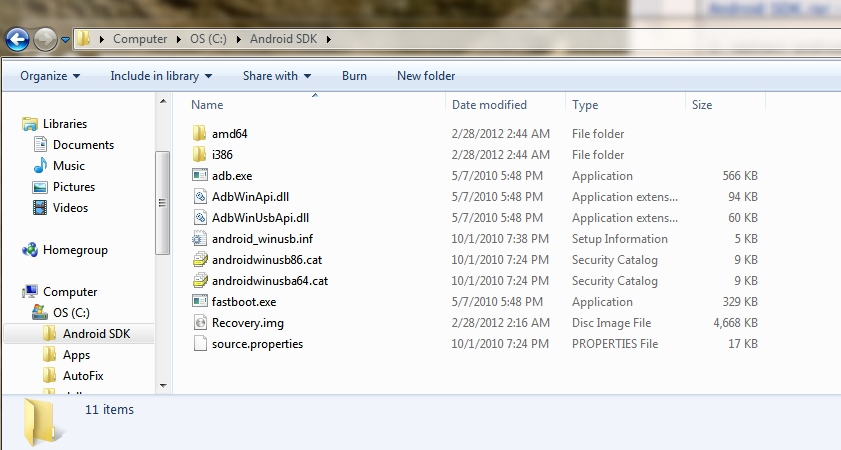

Windows 7. Looking at it, just saw that there's an Android SDK folder inside of the Android SKD folder. The folder must have been zipped into zip file & when unzipped, it went into another folder of same name. Didn't notice. Will fix it & start over. It's amazing how many frustrating little things can happen--lol!
Redid everything... no change. Here are screenies. Sometimes words don't work so well. :)

In setting up Andriod SDK on Windows, I wasn't supposed to run any of the executables in the folder was I? It just needed to be extracted to the right place (c:\)... right?

Hmm... a couple of reboots and a different usb cable helps me with the driver error... it happens to everybody at least once. There has to be an easier root method for i-wireless Warps...
