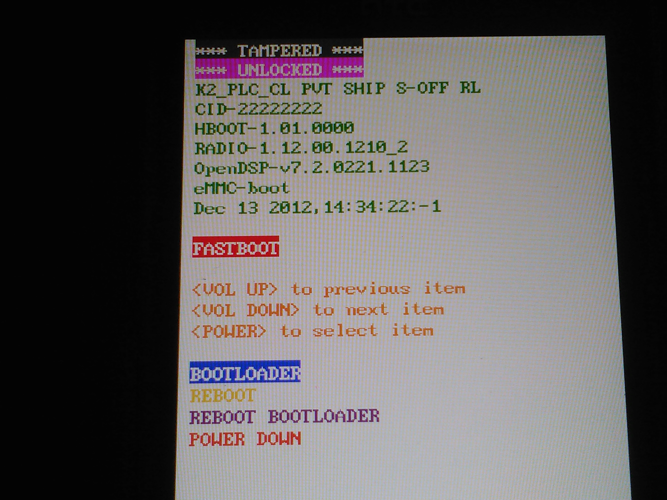

Anything I can help do for the development of a cricket kernel as well as some more tools/roms I would love to test anything. I have attached a screenshot of my bootloader with some information. Thanks in advance and looking forward to the development of this phone..
