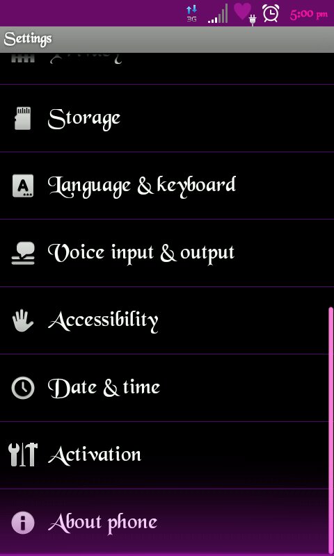

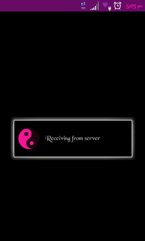

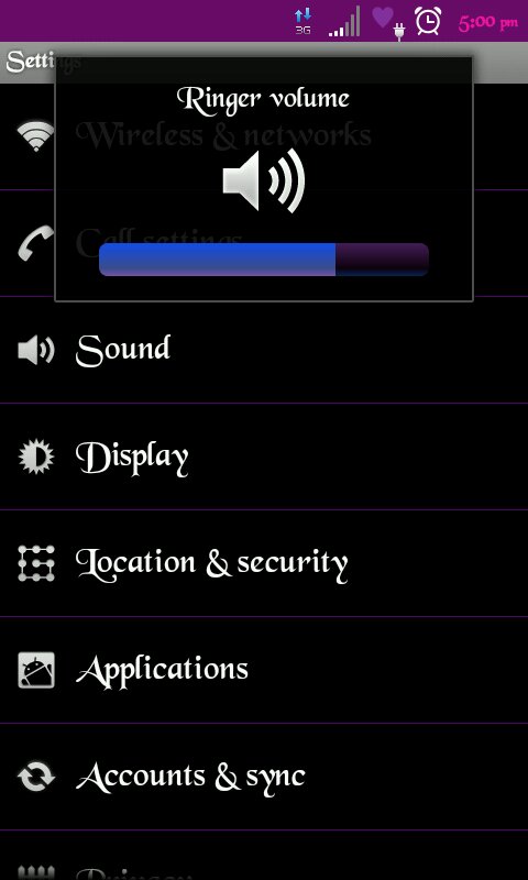

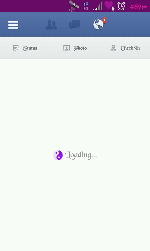

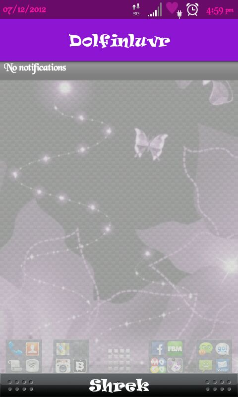

I themed this rom it was my first time theming I oh so proud of myself watch out there might b a rom coming soon to.... Lol
