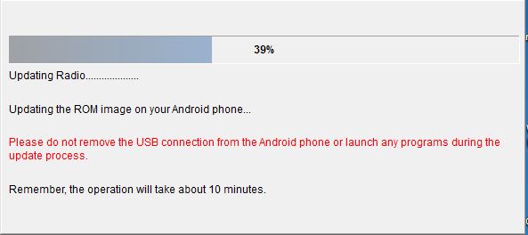

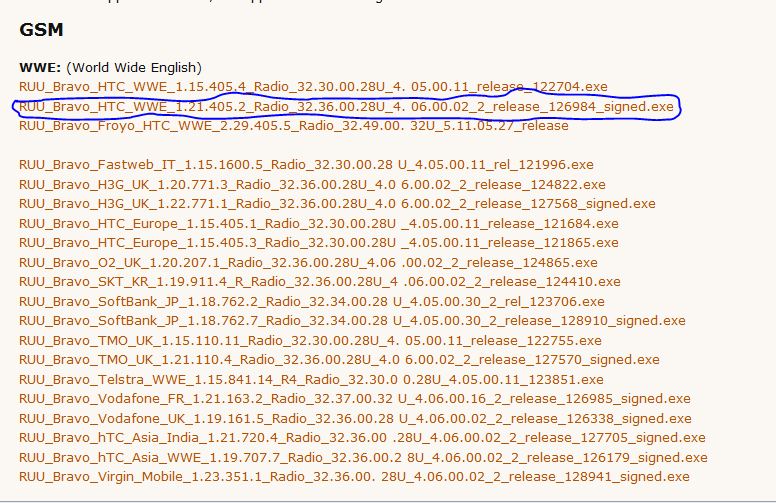

I download the RUU from the XDA site and put the phone in fastboot mode. I then run the .exe file i downloaded.
It rebooted the phone and started the update. It has been stuck at 39% for past 30 min. I think there is something wrong. I have attached screenshots of the progress indicator and the RUU file I downloaded. Please advice.

Thats a 2.1 RUU!!!! Thats never going to work as you can't go backwards.
That whole thread contains only 2.1 RUU's. Garrgghhh!
You should use the one from the useful downloads thread linked in my signature.
You're going to have to wait it out and see what happens. Disconnecting whilst flashing radio can be very risky.

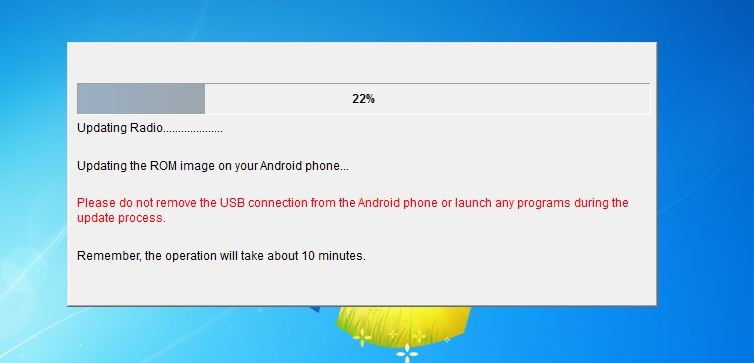

I retried the recovery again with the RUU i downloaded from your dropbox.
This time, it started the recovery process and it is stuck at 22%. Screenshot below.
I hope I am not asking for too much, but really need some more ideas.
Is there an alternative way to flash the ROM?????
