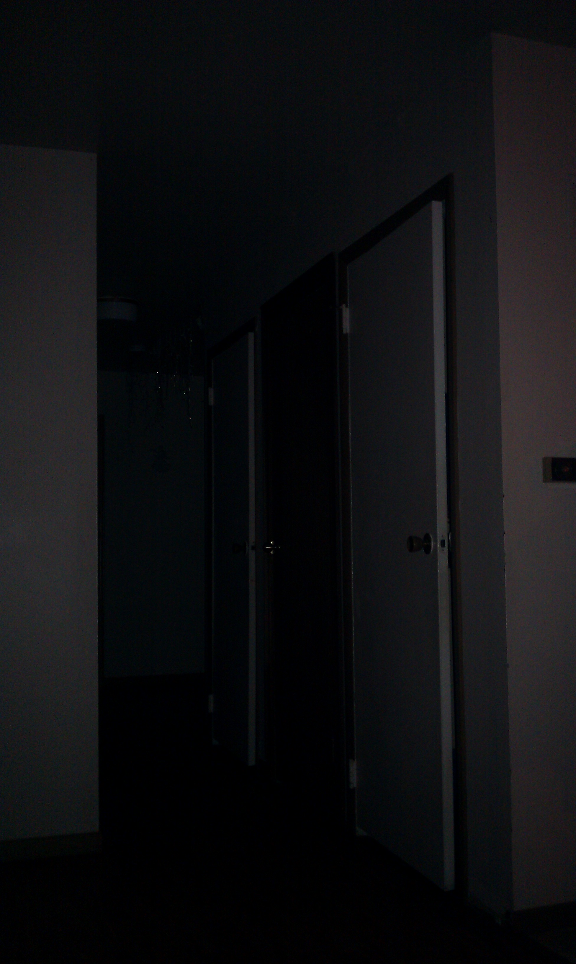

Hi.. my evo is not rooted.. so it is happening with non rooted and rooted phones.. my ISO is always been set to auto and i still have dark pictures. Here is a sample picture with the flash on and with ISO set to auto and everything set to default.:(

That is exactly how my pictures come out. I actually have my ISO set to 800 in low light but still have the problem. I mean I understand that it is a phone and not a camera, but hell, it took great pictures before the GB update. Now it sucks.
