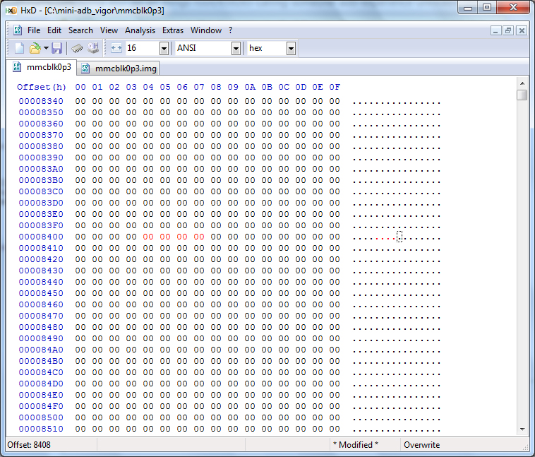

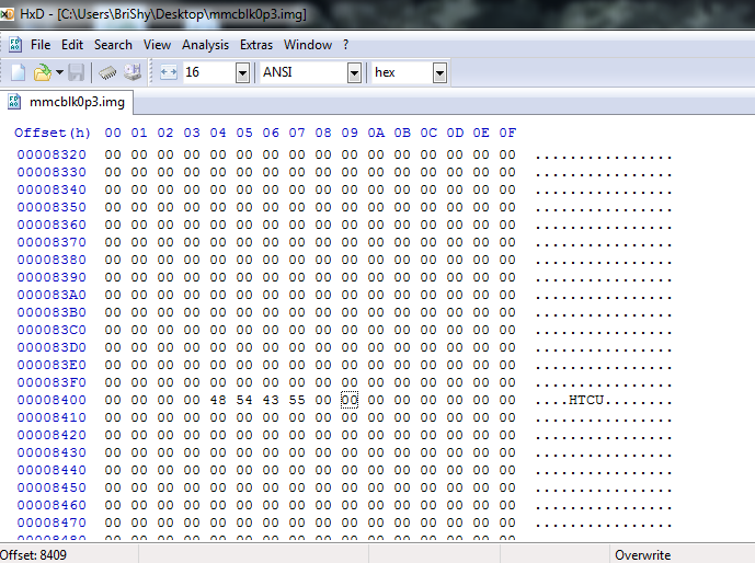

at 0x8404,right where it should be!
since i see youve got a hex editor,if youre comfortable editing it,just change 8404-8407 to 0's. dont change the period side,it wont be the same result(tho when you enter the zeros,the HTCU will change to periods)
*make 100% sure that you do not change any other parts of the file,or change the offsets by accidentally deleting something.
after youve made your edit,save it as "mmcblk0p3mod" dont change the file type.

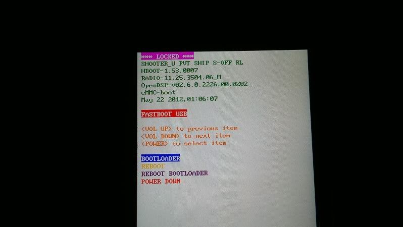

you should be back to **locked** :)

Scotty what is the RL next to the S-OFF in my screen shot above mean. I really never had the urge to get into the technical aspect of the phone as I have always left that to the tech junkies, also I guess I never really had the time, LOL I must say though, I am really getting more intrigued about it now though and I guess the more you know the easier it becomes to help others and understand the core of the issues.
don,im not 100% sure what the RL means... my rezound is RH. i read something about it being speculated to be a production or location code of some sort.

K, at first I thought it meant ReLocked, LOL thanks for the info Scotty ;)

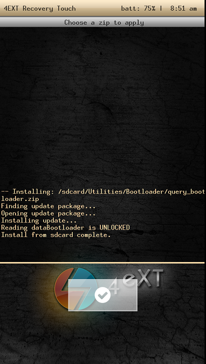

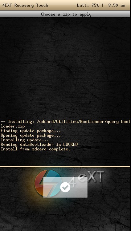

besides looking at the hboot screen at the banner,running the "query" zip will display on the recovery screen the lock status :cool:

Works like a charm! Scotty, you are a freaking genius! :D Literally takes seconds to switch between locked and unlocked! Amazing!
Locked:
attachment.php
Unlocked:
attachment.php
