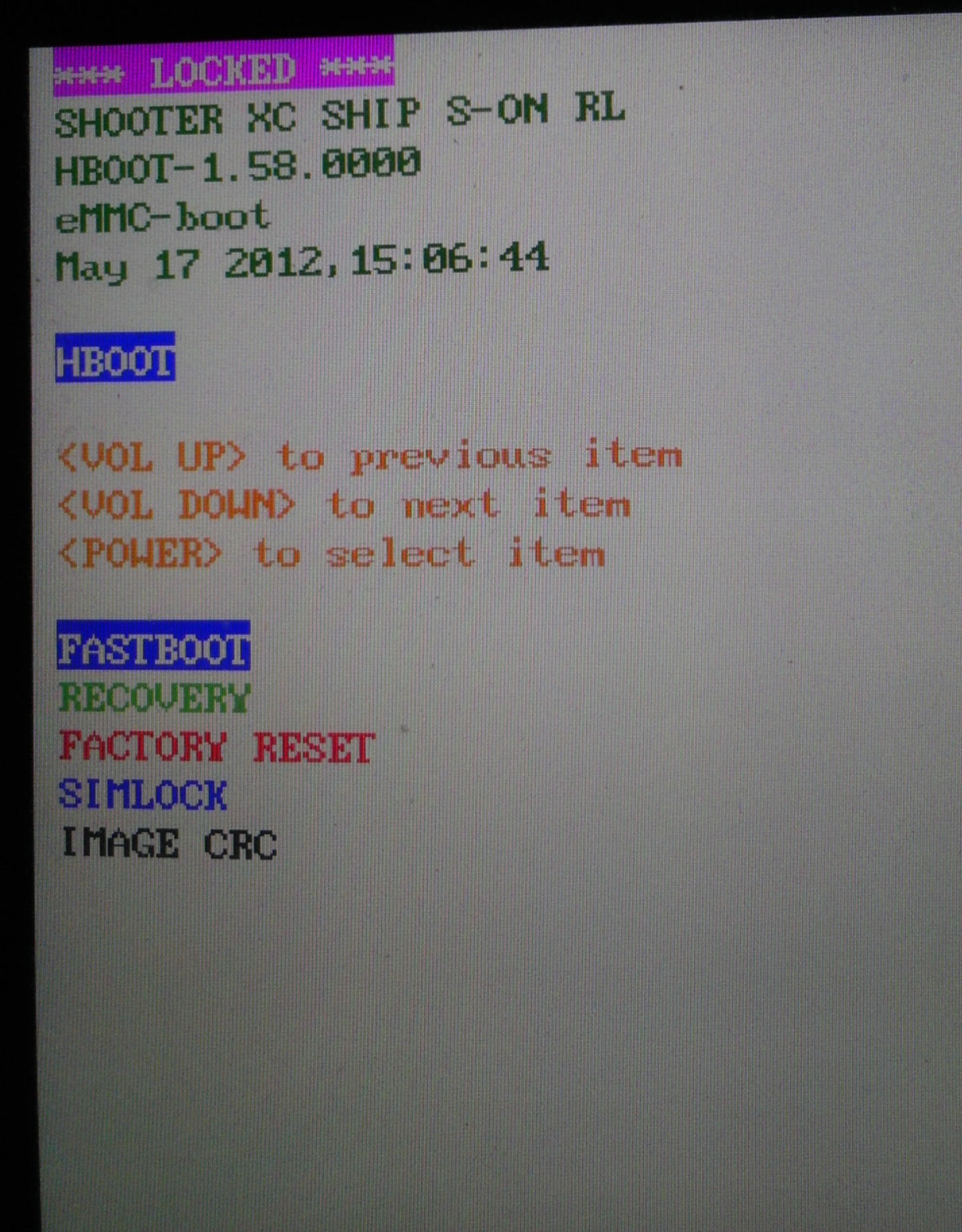

I am on HBOOT 1.58.0000 & I have a CDMA Evo3D with Sprint.

Didn't realize you weren't rooted yet. I will post this here in case you miss it in the other thread. If you root, you should go all the way and get s-off as well!
You mentioned being on hboot 1.58, and I don't think I've seen any JB roms that are compatible.
If you are s-off you can change hboot versions very easily.

Here is a pic of my details. Totally stock, first generation Evo3D. Got it first day & never root'ed or anything.
I'm pretty computer savvy. Build my own PCs & all that good stuff. When it comes to rooting, I'm totally ignorant. I have been reading about it all week trying to decide if I'm up to this lol
~ ArmyX
~ ArmyX
