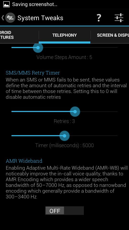

Brian your way more talented then me but have a fresh copy of your rom backed up & try these features in pimp my rom, off the playstore, try a few different roms maybe some roms will work better then others
