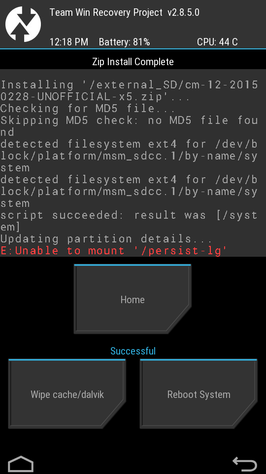

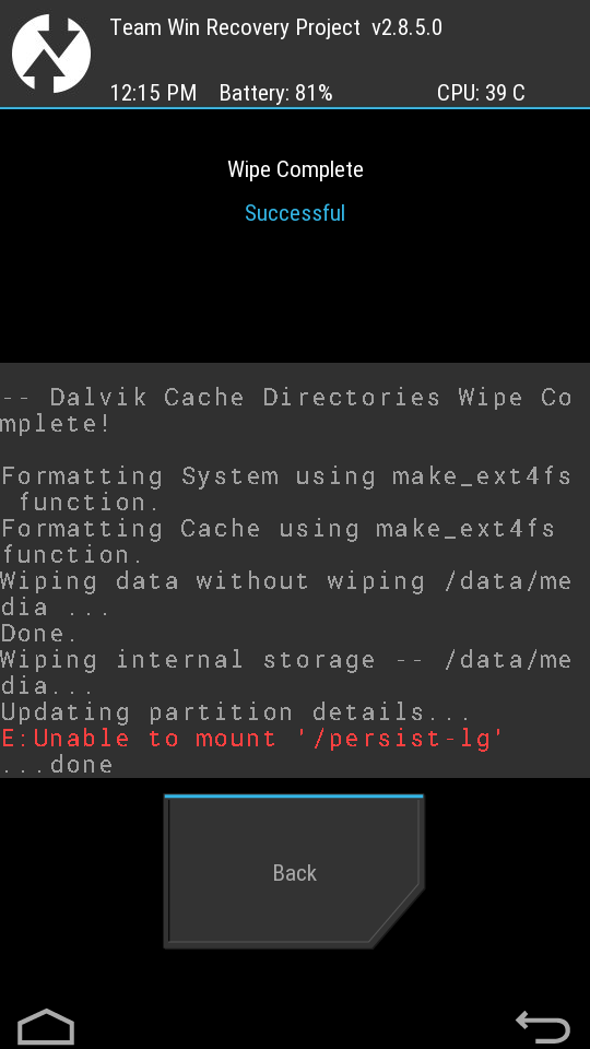

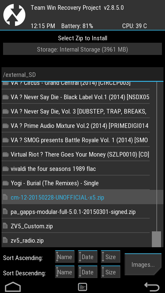

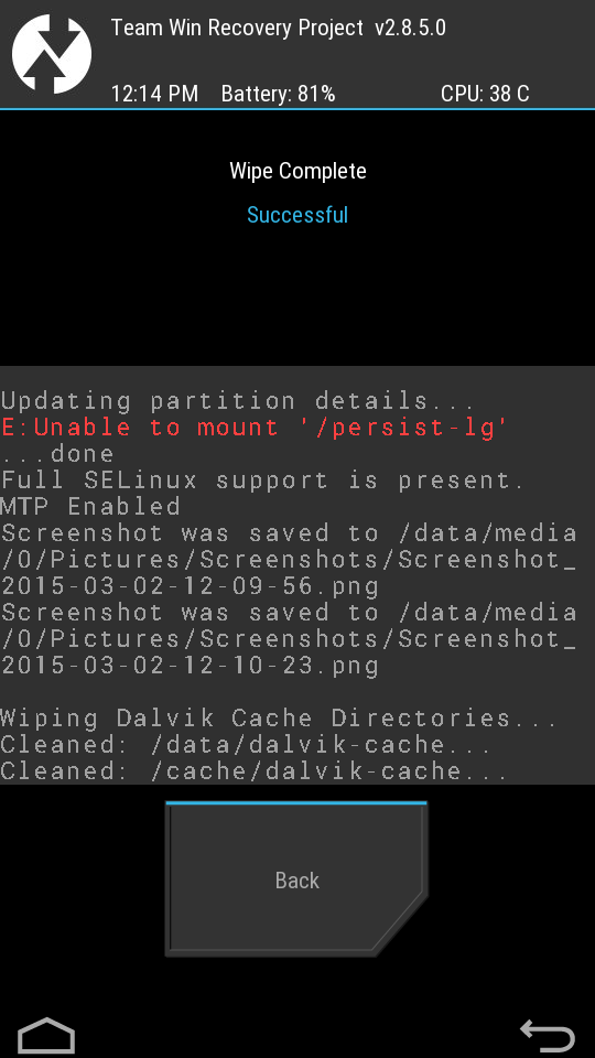

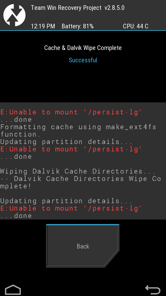

I've followed every single way on here, and I can not get this rom to work. It stays on the boot logo and thats it.

Hey furryoflife, I just have two questions for you that may explain your issue. 1.Do you have custom recovery installed? 2.Are you formatting Data/Cashe before you flash? *Please Note: Make sure you backup if you don't want to lose all your data when a you format, which is required to flash any custom ROM on any android device. Hope this helps! :) -Jake
I have the Lollipop TWRP Custom Recovery installed, and I am formatting everything but the SD. I also have a backup so nothing bad happens. I honestly do not know what the problem could be. I am flashing from the zv5 debloated custom rom. The zv5 rom gave me no problems what so ever.
Well it sounds like you are doing everything correctly, I use the same exact method with the same recovery, which option do you use after you select Wipe in TWRP, Advanced Wipe or Format Data? Also what carrier do you have, and could you take a screenshot of the terminal line after you attempt to flash? (You can take screenshots in TWRP)
My carrier is Virgin Mobile. I will take screenshots.
Virgin mobile could possibly be the problem, I personally have boost mobile, and one more question for you, how long do you wait for the boot logo? And let me just ask everyone, Who here has virgin mobile and successfully flashed this ROM?

have tried all
CM/TWRP
ZV3
ZV4
ZV5
LP TWRP
2/25 CM12
Only thing left to flash is OMNI now
And on 2/25 clean flash at the moment
13_14_4183upper.png 13_15_1360upper.png 13_15_5161upper.png 13_18_1787upper.png 13_19_5271upper.png
