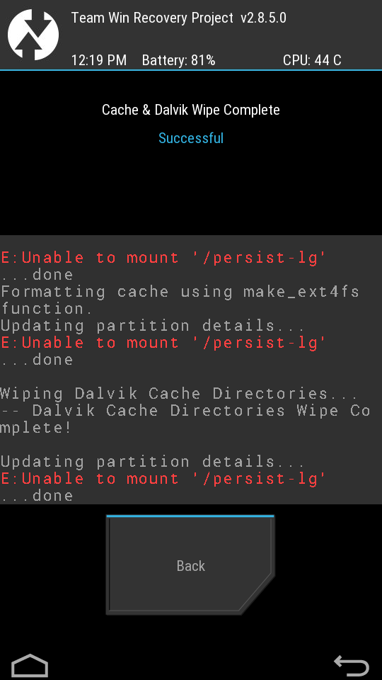

try downloading image again

Pretty sure your doing it correctly, but think you may have a corrupted DL. Check the md5 sum on dl page against yours
I honestly do not understand this. It still will not go past the boot logo. The md5 matches perfectly. I checked it.
I think something is wrong with your recovery? Why does it say unable to mount?
I suggest redownloading and reflashing recovery
Mine does not say that in red
I'd also say that something is wrong. Try to use the lg flash tool to downgrade to zv3, then flash twrp and the cm12 ROM. It looks like your persist-lg partition is corrupted for some reason, are you sure you didn't format it or erase something on that partition?
Try to go into mounts in twrp and uncheck the box next to persist-lg and try flashing cm12 again. See what happens and let us know.
