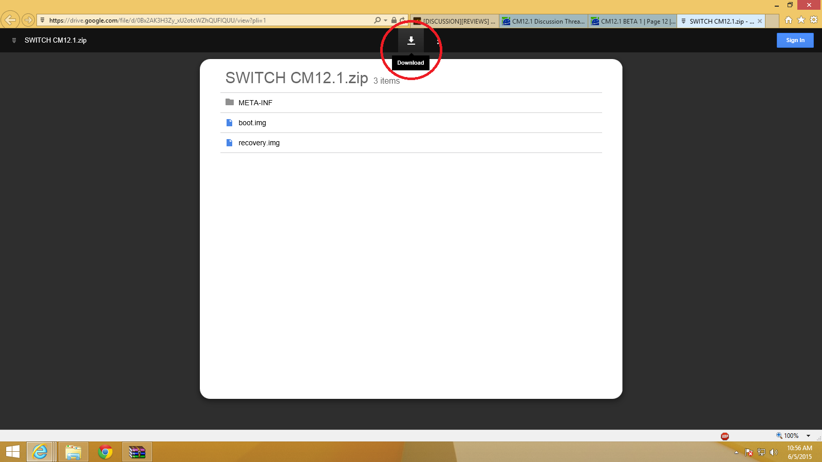

these links bring me to a page that contains the boot.img and recovery.img files but not the zip files you are referring to
Click were I have circled red. You might have to hover the mouse or touch on the top for the download button to appear.
