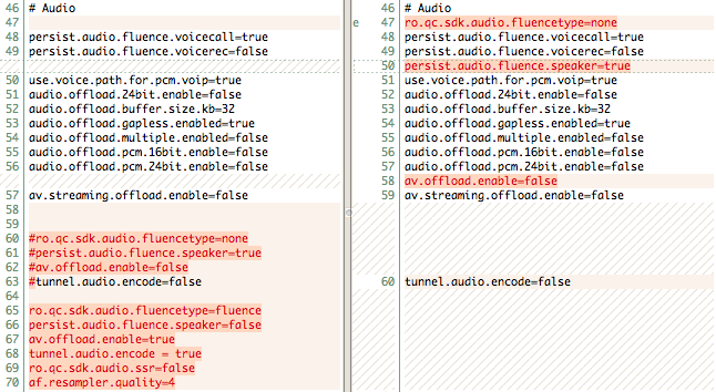

you may have already disclosed this, but i would like to know which variant of the zmax you have? i am on rc2 and my sound is perfect... just loud enough.
Thats weird.. I flashed rc2 twice and still no luck with the sound quality. I have the T-Mobile variant. I am very satisfied with beta2 anyway, it's damn near flawless. ;)
if sound was better in beta2 it has to be a build.prop change I made
can you compare the two props, and then list the differences, and then we can figure out wich ones are audio related

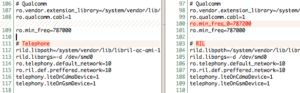

here are the differences on the two props
the one on the left is beta2, the one on the right is rc2
I figured these images would make it a little easier to see the changes:

so it looks like there are some prop setting there that you can change and test, if audio work better with those changes let me know and I will include them in next release, or we can make a zip to flash the new build prop, and I will put it in the OP
