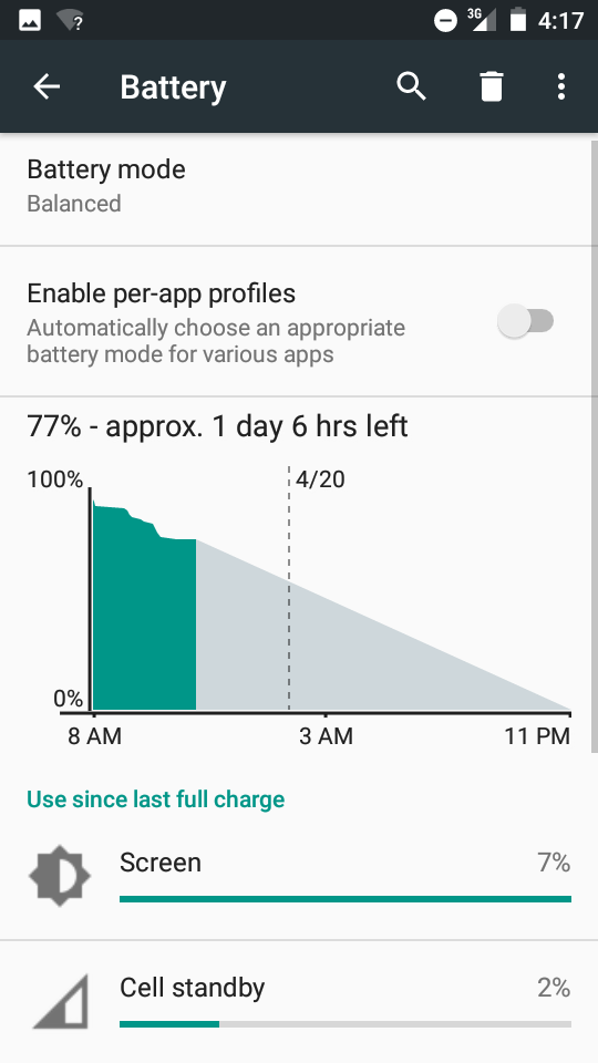

This is just me personal opinion but there isn't much wrong with this ROM for me at least. Works great. I will report back tomorrow with some overnight standby tests on battery life.

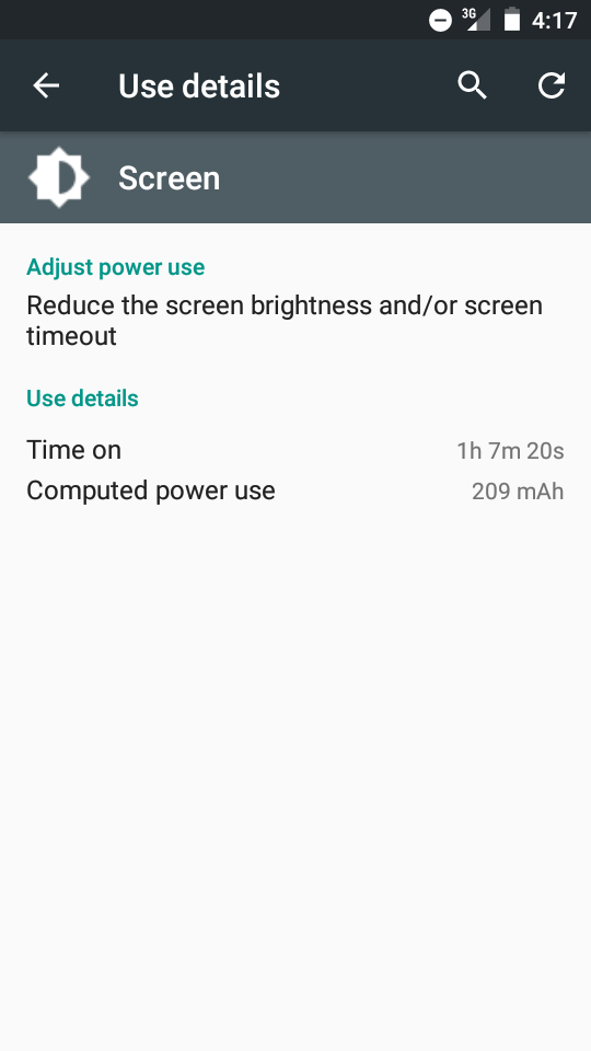

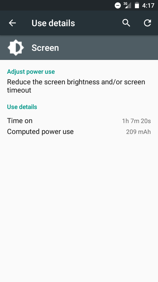

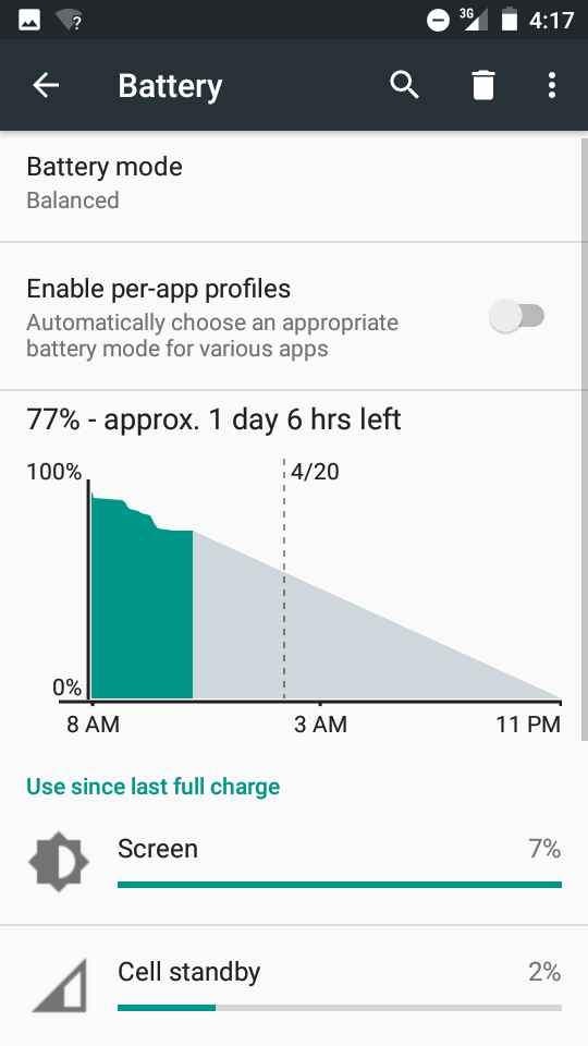

I can confirm that HD videos are working. No green tint on my end so far. The main problem I've had is Google play services force closing every 5 seconds but that's because I dirty flashed over CM11. Other than that I haven't found any serious problems yet. Almost tempted to use this as a daily driver now. :D
EDIT: After using this for a few hours I've noticed that HD videos sometimes lag and freeze at random points, I'm not sure if anyone else has that problem. Also when I reboot it will sometimes reboot itself 2 times before fully booting, once again not sure if its just a problem with me.

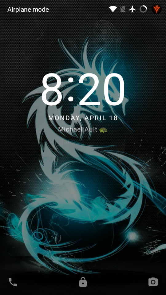

BTW I love the lock screen :p

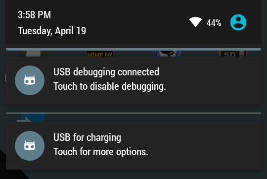

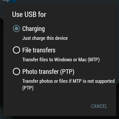

Folks, Thanks a lot for your efforts. My Volt now runs smoothly. Just one minor problem so far. It does not connect to PC via USB, the Volt icon does show up on desktop, but there is no access to either internal or external SD. If I put the phone into Recovery Mode, then everything is fine.
Best solution for an External SD is to just take it out of the phone and use a micro SD adapter if you have one. The connection problem will hopefully be fixed soon
The phone connects in charge only mode, you have to select mtp (file transfers) from the options.
