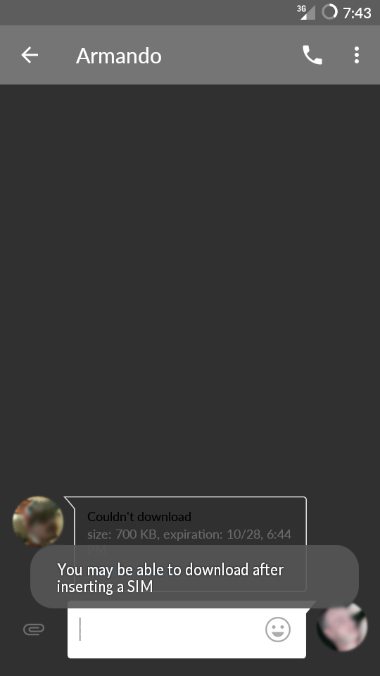

Thanks andMego, I did and it is working great! I do have an issue still with the LTE setting. I tried several different options but I can not establish an 4G/LTE data connection, resulting in that no MMS messages can be send or received.
And with that I also get a strange message when I try to receive a picture in a text message. -"You may be able to download after inserting a SIM" - But my SIM card is already installed
Details...? Which Carrier?
That's really strange since I think I only get MMS on 3g and on 4g it doesn't go through.
Did you flash the proper APN settings?
Edit: I saw your posts in the other thread
