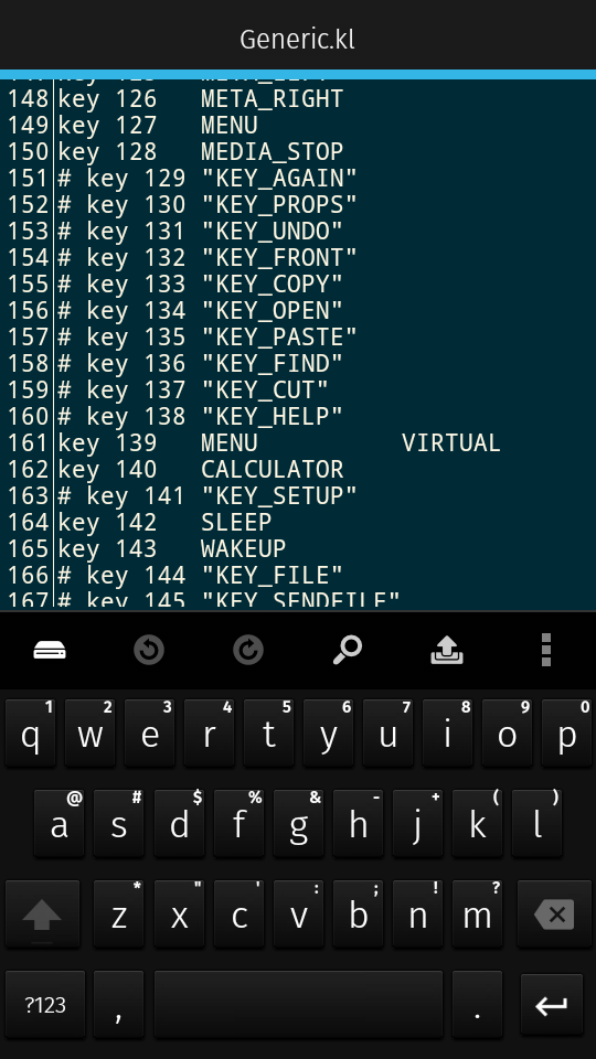

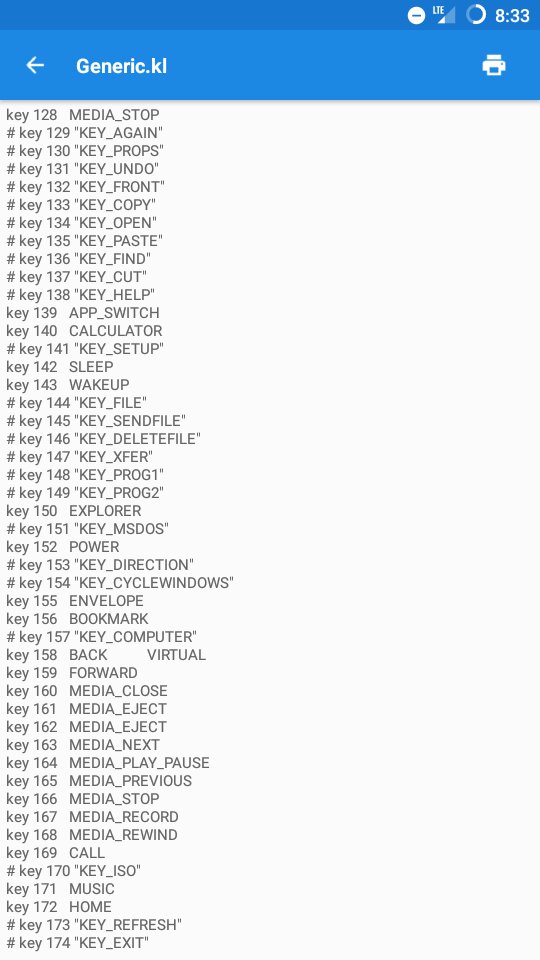

How do I remap the menu button to work as the recents button without xposed?
EDIT
Found it!
1 - Open /system/usr/keylayout/Generic.kl with root explorer and change
key 139 MENU
to
key 139 APP_SWITCH
2 - Save file and reboot. Now menu key will bring up recent apps, just like S5.
How do I remap the back button to work as the recents button without xposed?
EDIT
Found it!
key 139 MENU
to
key 139 APP_SWITCH

Sorry :) Remap menu for recent
So 139 is menu virtual, erase whole thing or just replace menu?
Is 139 the long press of menu button?
Out of curiosity why don't you just use the long press on home for recents (which is default)?
Can I just say that I lost my cellular data usage meter and only the wifi meter? Is this just something I disabled?
I'm not sure I get you're question but yes you are able to disable and enable the WiFi meter from the drop down menu

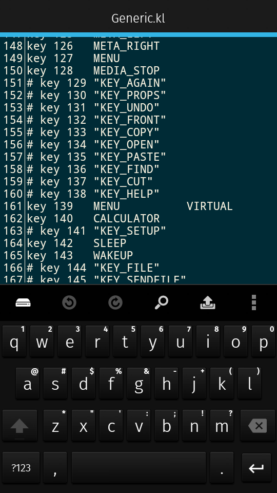

Erase whole thing. Long press? Short press I think. It's faster and I'm more used to it since I use Motorola phones a lot. Why did you put that same screenshot twice?
