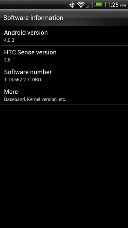

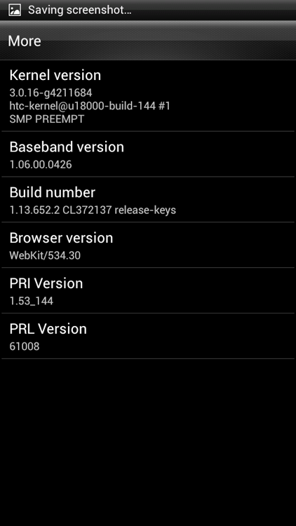

What are the odds that the RUU will leak for the EVO V? I pretty much know Ill root it the second I activate it (waiting till the end of the billing cycle 6/11). But god forbid something were to happen to it I would love the ability to reset the things back to default for warranty purposes.
There are ruu leaks out already. I just need someone to post their software version. If the leaks aren't the shipped version I can get the shipped version
Here is from my evo v 4g...
