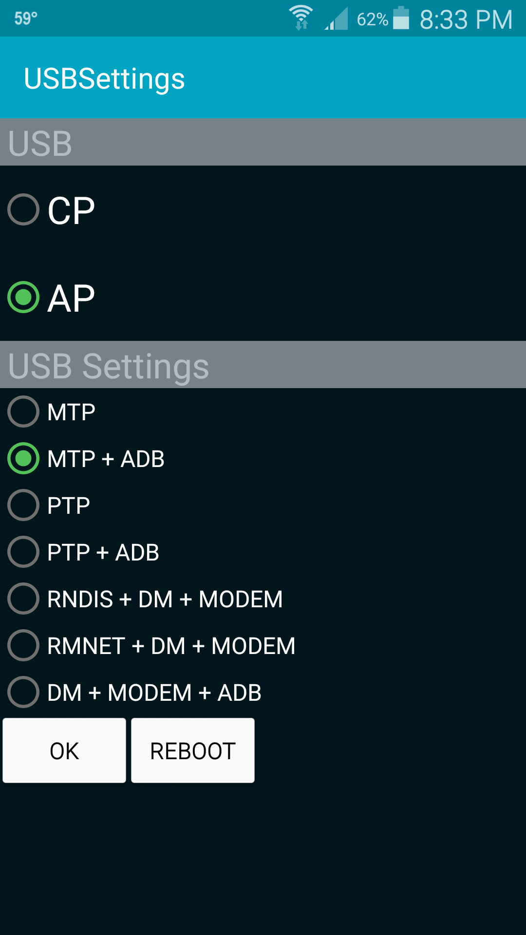

You could check Settings in USB hidden menu. On you phone keypad dial *#0808# and it should take you to the menu. Should look like this. If selections are the same tap OK to leave menu.
@Jfalls63 I just tried it both (with and without the sim card), and still nothing. I ought to mention that my phone does recognize the computer, as it said "connected as a media device" but Windows still claimed it has malfunctioned. I'm really lost here...
