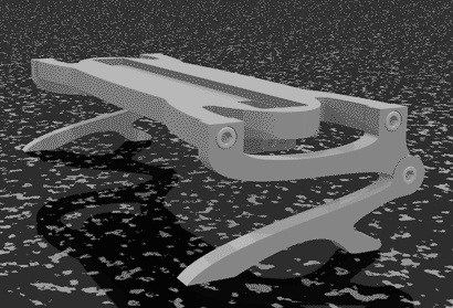

My only concern is the choice to leave off the back support. I worry a little about the stress placed on the usb connector in the phone, since that will be the only thing keeping the phone from tipping out backwards. Sitting flat it shouldn't be a problem at all, but tilted back it may be. I just don't know. I liked the idea of a couple simple pins at the top and bottom for the phone to rest against. You could maybe cut out short slots to make their position adjustable. You could then place your phone in the cradle, snug up the pins and lock them in place. I know that is adding more complexity, so it may not be feasible, but it would make me more confident in tilting the phone back.

What I was originally going to do was just oversize the hole so pretty much any cable could be used. I really hated the idea of having to fumble around inserting the cable from the bottom each time you wanted to dock it though.

As far as the hole you might have some adapter / dock height issues if you just had the hole. I have some ends on cables which require quite a bit of clearance to bend out of the unit. That 90 degree cable was nice.

This is directed to everyone concerned about my decision to not implement a back rest.
The phone won't be relying soley on the usb connecor for support. The phone it self will rest on the bottom and since there is a pocket it sits in I dont see it being an issue. These phones weigh around 4 to 5 ounces so there is virtually no so stress on the connector that would cause any problems.

Alright here is a picture of the underside and an quick animation. I didn't take the time to render it out, but you will get the idea. ;-).
Click the attachment to see a small animation of how it will pivot. Nothing special, but you get the idea.

finally I can get my hands on a dock of some sort. Nice job!! Been looking for one forever. Definitely needs to be leaned back a little so that the phone is at an angle but other than that I AM ALL IN!!!! LET US KNOW WHEN YOU ARE READY TO SHIP!!! (wont hurt to assume that you will make enough for all of us):D
