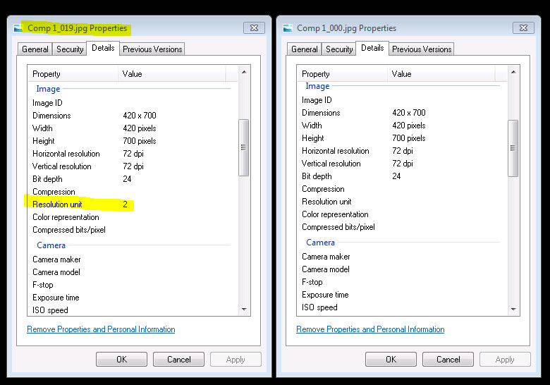

I don't know how much help I can be here. CornfedChris might be the man. However when I first tried to make a boot animation it failed because I used different formats on the export of the image. It shouldn't matter if it's jpeg or png but it matters on the image properties. Take a look at what I mean in the image I attached.
So make sure the resolution unit is at 2 ?
Yes, if you notice your new images have that unit resolution 2 but the original ones don't. All images need to be identical on the export. Paint.net seems to be adding the 2 so I would go back and export all your unedited images so they all have the same resolution properties and try it again.
