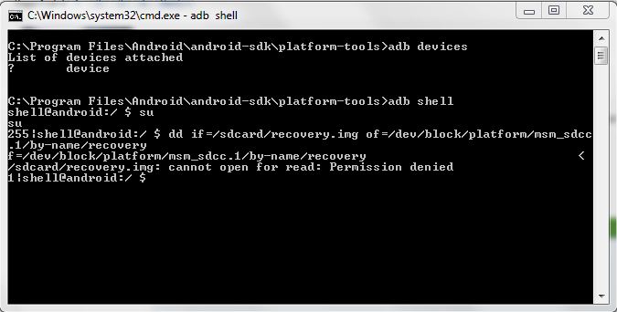

Cant get this to work.My phones soft bricked.I replaced a system files that the phone did not agree with. tried a factory restore which I think made things harder on myself. I can get into the FTM mode and the restore screen. any way, any ideas on what I need to do to move forward with this and get this thing up and running again. heres a screen shot of what im getting on command prompt
