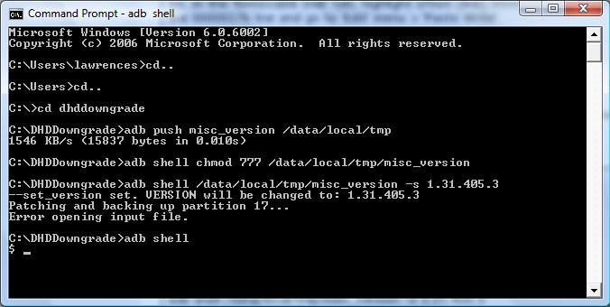

Hi All,
First up i would like to thank Cubz for writing up the downgrading guide. Unfortunately like Zzchesss i've hit a "Main version is older" brickwall.
Basically everything goes well thru to the bootloader screen, the patching blue bar completes, the gold checking bar completes, however after that it says:
Patch fail
Press power to reboot
My version is 2.50.178.4 CL91002
Type everything in cleanly and still the same. I've included an attachment.
You've not rooted, you've skipped that part of the process by the looks of things.
You need to attain temp root with these commands
Code:
adb push fre3vo /data/local/tmp
adb shell chmod 777 /data/local/tmp/fre3vo
adb shell /data/local/tmp/fre3vo -debug -start FBB00000 -end FFFFFFFF
Then if you see a "#" on the command line, enter the below:
Code:
adb push misc_version /data/local/tmp
adb shell chmod 777 /data/local/tmp/misc_version
adb shell /data/local/tmp/misc_version -s 1.31.405.3
adb reboot bootloader
