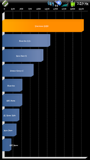

I'm also limited to 1.15 using JRummy's app. Using low voltage now and it's stable. Have yet to try manually editing and applying setscaling file. I was able to quad a 1600 on this :)
DX 2.2 OTA deodexed and themed. I'd love this thing to be stable at 2 but as much as I use it the battery would probably only last an hour!
I wanna see a real 2 ghz setscaling
Or one above 1.4 that's stable
