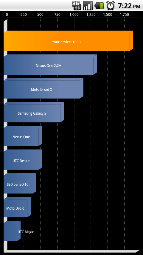

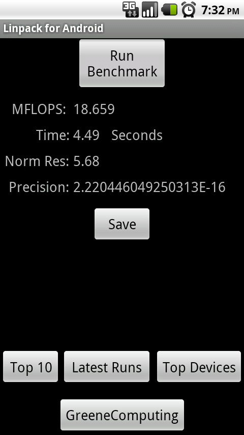

was able to find a stable 1.225, linpack 16.35 (first run) 17.074 (second run), quadrant 1721(first run) 1717 (second run)

So im.stable at 1.4 ghz with at vsel of 68. Hope that doesn't kill my battery. Anyone know?
Same here, used Fab's other settings for the lower speeds and it seems to be screaming along and the battery is doing well. Will see here in a little while as the girls have been playing angry birds for over an hour on it.
Stable at 1.4 ghz... surprisingly... tried dropping vsel down to 65... didn't work. So I stuck it back at 68. Anyone know if this will hurt my Droid X? I know overclocking usually doesn't, but do you think at 1.4ghz it will? I know incredibles go there all the time with no problem...
